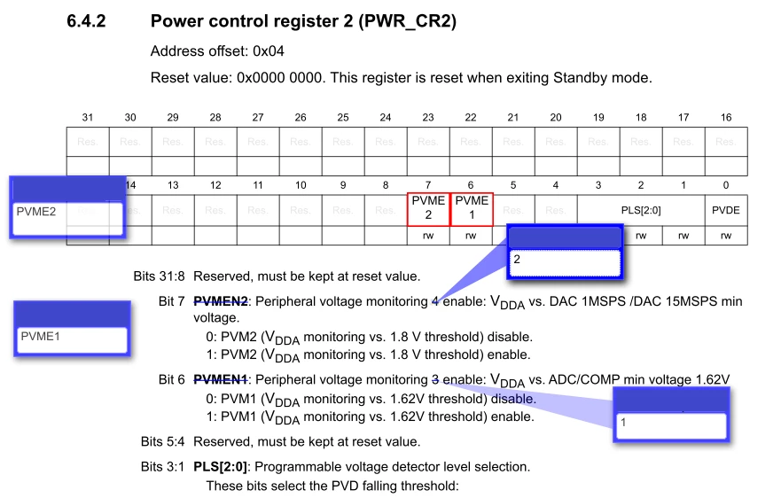

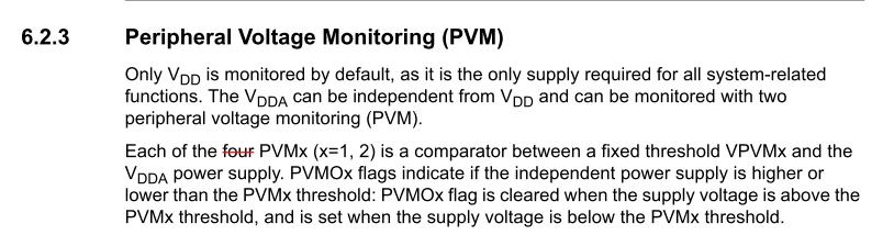

In RM0440 R6 6.2.3 there is "Each of the four PVMx (x=1, 2)". So 4 or 2 PVM ?
In the PWR_CR2 register 6.4.2:
Bit 7 PVMEN2: Peripheral voltage monitoring 4 enable
Bit 6 PVMEN1: Peripheral voltage monitoring 3 enable
=> PVMEN1 is for PVM1 or PVM3?
=> Only 2 PWM specified
In the file stm32G431xx.h:
There is bits définitions for 4 PVM.
Example for PVM1:
#define PWR_CR2_PVME1_Pos (4U)
#define PWR_CR2_PVME1_Msk (0x1UL << PWR_CR2_PVME1_Pos) /*!< 0x00000010 */
#define PWR_CR2_PVME1 PWR_CR2_PVME1_Msk
This define PVME1 (Not PVMEN1 as in the RF) as bit 4. The bit 4 is not specified in the RM.
So my question: how many PVMs and what bits to use in PWR_CR2 ?

Hello @Nikita91​ ,
Thank you for pointing out this issue.
In STM32G4xx, there is only 2 PVMx (x=1,2).
So, in RM0440 the PVMENx should be renamed to PVMEx (to be in line with HAL definitions):
Also, the mistake of 4 PVM thresholds will be corrected and this text should be updated (remove "..the four") :
Note that the next revision of the RM0440 is planned in the first quarter of 2022.

Thank you for the manual clarification.
But what is the correct PWR_CR2 bit to use for PVM1: bit 6 as in RM or bit 4 as in stm32G431xx.h ?
Dec 14, 2021 2:32 PM UTC
It's Bit 6. as in RM0440.

@Imen DAHMEN​  : So don't forget to fix CMSIS files like stm32G431xx.h
