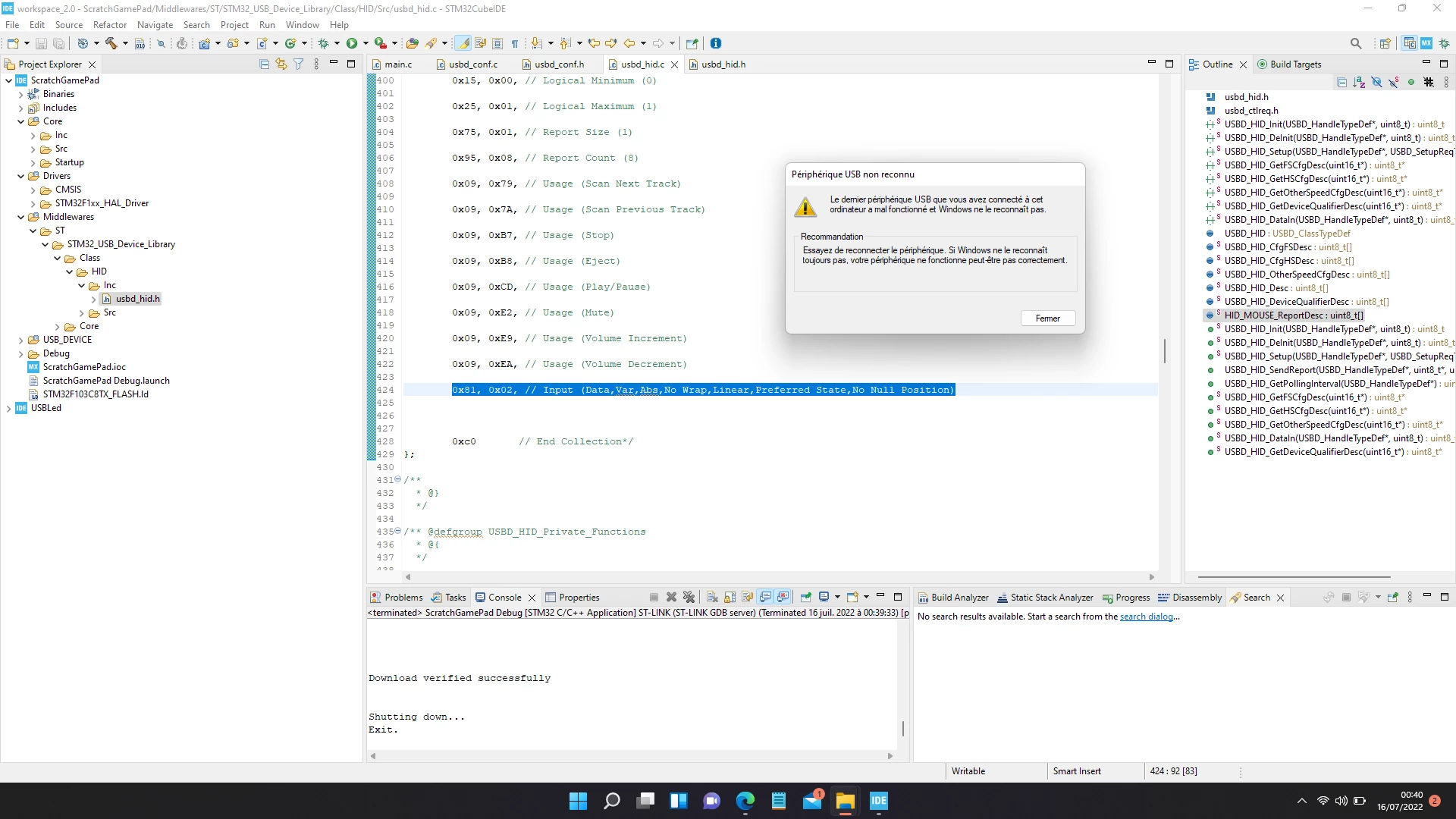

Hi everyone,
I follow this tutrorial to mak a keyboard with a stm32 MCU.
But it's not works. The USB not recognized!
Could you help me please?
Thanks!

Hi @FBOCA.1​ ,
Try to increase the heap size, or configure the USB library to use static allocation.
For more explanation, I advise you to follow this article to solve the problem.
Make sure also that you are not facing this particular case.

Thanks @KDJEM.1​ .
But i solved my problem. When i bought my MCU, the reference which write on the chipset was not the same on the product description on the website.
I configure my project to the correct reference STM32F103C8XX to STM32F103C6XX and now all working fine!
