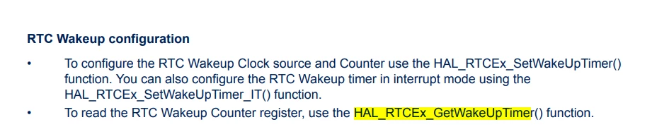

Hello @jinyi7016
The function HAL_RTCEx_GetWakeUpTimer() get just the value of WUTR register previously set with the function HAL_RTCEx_SetWakeUpTimer_IT().
Please refer to the UM174 more details.

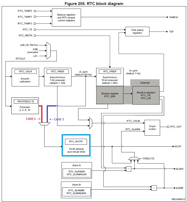

Hi @jinyi7016,
Here is a solution. However, it supposes you are not using the RTC Calendar, only the RTC WUT (Wake-Up Timer).
To better illustrate it, I join the figure below adapted from the reference manual of the STM32L0 series. The idea is the following:
  • manage to tune the RTC's prescalers to make the RTC_SSR register synchronous with the WUT counter,
  • read the RTC_SSR register once the WUT counter is launched, then when we want to know the current value of the WUT counter, to finally calculate the difference.
There are two cases:
  1. The source clock of the wake-up timer is the RTC's clock source RTCCLK (HSE, LSE, or LSI clock) divided by the WUT prescaler.
  2. The source clock of the wake-up timer must be the RTC's asynchronous prescaler counter.
Let's dive into the details and steps:
    • For this, WUCKSEL[2:0] = 0xx in the RTC_CR register.
    • Make the RTC_SSR register synchronous with the WUT counter. For this:
      • Set the synchronous prescaler to 0. For this, PREDIV_S[14:0] = 0 in the RTC_PRER register.
      • Set the asynchronous prescaler to the same value as the WUT prescaler. For this,
        • PREDIV_A[6:0] = 15 in the RTC_PRER register if WUCKSEL[2:0] = 000xb in the RTC_CR register.
        • PREDIV_A[6:0] = 7   in the RTC_PRER register if WUCKSEL[2:0] = 001xb in the RTC_CR register.
        • PREDIV_A[6:0] = 3   in the RTC_PRER register if WUCKSEL[2:0] = 010xb in the RTC_CR register.
        • PREDIV_A[6:0] = 1   in the RTC_PRER register if WUCKSEL[2:0] = 011xb in the RTC_CR register.
    • For this, WUCKSEL[2:0] = 1xx in the RTC_CR register.
Now, to estimate the current value in the WUT counter:
  • Read the RTC_SSR register when the WUT counter is launched at t=0µs.
  • Read the RTC_SSR register at t>0µs.
  • Calculate the difference.
I hope this helps.
