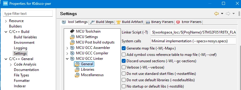

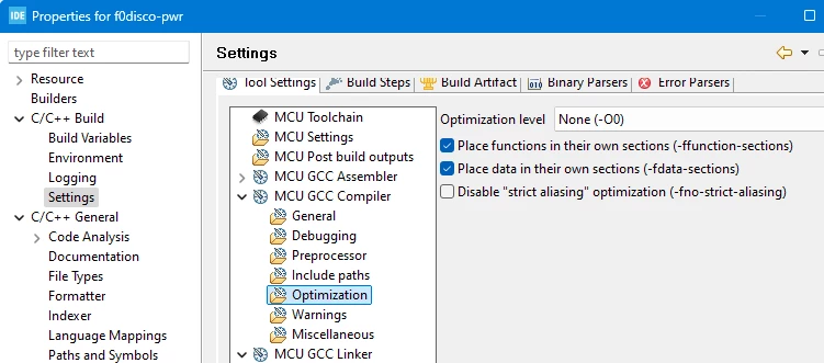

Andrew Neil
Sep 23, 2024 9:01 AM UTC
What optimisation level are you using?
By default, 'discard unused sections' should be enabled - so unused functions shouldn't appear in the final image.
FredoliveAuthor
Sep 23, 2024 9:13 AM UTC
Hi Andrew,
I have -O1 optimisation and your configuration setting.
I give an example of my end Hex file :
0x8005FD0 ........../Drivers/STM32G4xx_Hal_Driver/Src/stm32g4xx_hal_wwdg.c .....
This link in hex file isn't necessarily...
