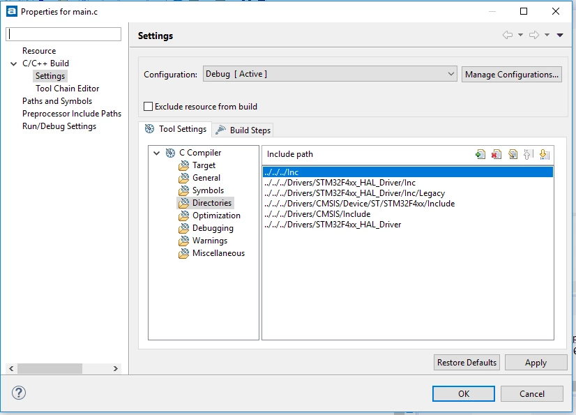

GSome
Visitor II
Dec 3, 2018 2:56 AM UTC
To load project into truestudio just drill down in the SW4STM32 folder to find
a ".project" no name just .project
Click on it and truestudio will load and convert it to a true studio project.
STM32F429I-Discovery\Examples\LTDC\LTDC_Display_2Layers\SW4STM32\STM32F429I-Discovery\
If have to be sure you have set up directory locations, I do not remember if default is set up when you loaded the project.
If not go to File -> properties ->C/C++ Build _> Settings ->Directories
