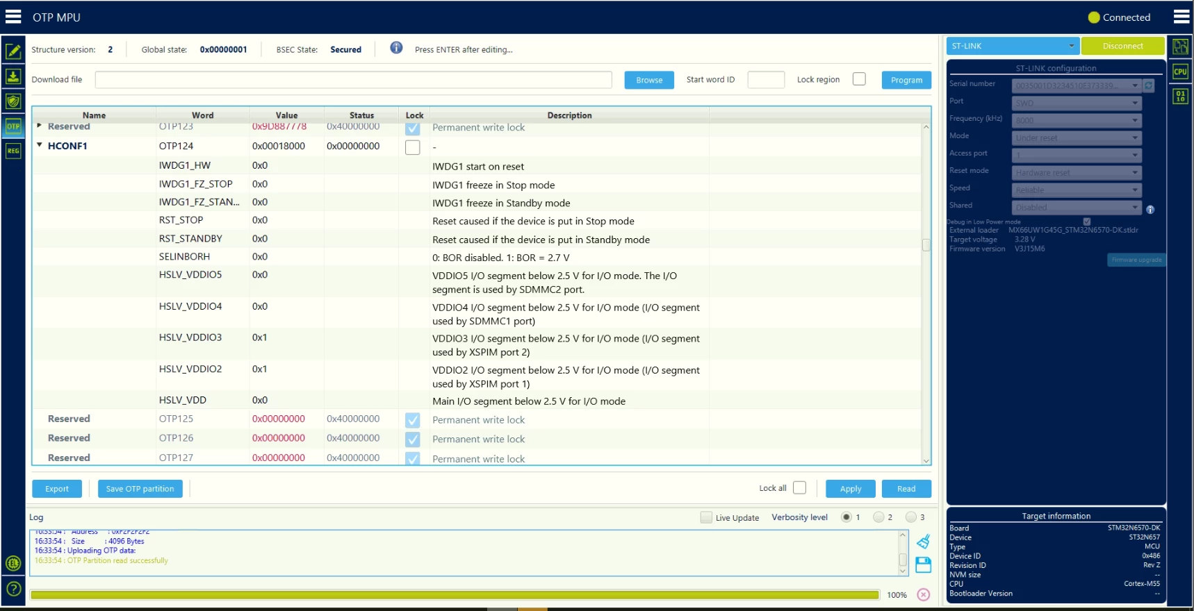

I'm working with an STM32N6570-DK and need the microSD slot (CN13, SDMMC2) to run at 1.8V signaling instead of the 3.3V default. The device I'm connecting only supports 1.8V, and the target speed is modest, around 25 MHz.
What's the correct procedure to make this switch on this board?
So far I've driven SD_SEL (PO5) high to flip U32, but CN13 pin 3 still measures 3.3V. AN5967 (Getting started with hardware development for STM32N6) section 12.4 points to PWR_SVMCR2.VDDIO5VRSEL together with OTP124 bit 13 (HSLV_VDDIO5), which currently reads 0 on my board.

  1. Is burning HSLV_VDDIO5 actually required for 1.8V operation, or only to reach the datasheet frequencies?
  2. Does burning it permanently prevent the slot from working with ordinary 3.3V SD cards?

HSLV stands for High Speed Low Voltage. Its main purpose, in my understanding, is to let the GPIO to work at expected High Speed when the GPIO is powered at Low Voltage.
answer: burning HSLV_VDDIO5 not mandatory for 1.8V operation, but mainly to reach the datasheet frequencies.  target speed around 25 MHz, I suppose no need to set HSLV_VDDIO5
  1. Does burning it permanently prevent the slot from working with ordinary 3.3V SD cards
answer (not 100% sure): burning HSLV_VDDIO5 to 1, does not permanently prevent the slot from working with ordinary 3.3V SD cards, as you said, another dependent point is PWR_SVMCR2.VDDIO5VRSEL
