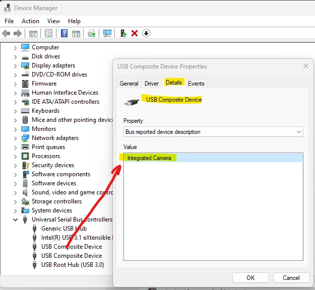

Pavel A.
Dec 13, 2022 12:44 PM UTC
@Javier Muñoz​ Windows has so called device install (Di...) API for reading properties of devices and discovering their connections/dependencies. This is documented in what once was MSDN.
The Device manager show many of these properties in the details tab:
0693W00000WKtmXQAT.pngThe name string from the device or function descriptor is "Bus reported device description". (this is optional, some devices do not have it)
The API is quite obtuse and painful to code.... but the similar thing in Apple OS/X is even worse IMO. It may be easier with libraries/wrappers for modern languages like C# and WinRT, I'm less familiar with these.
