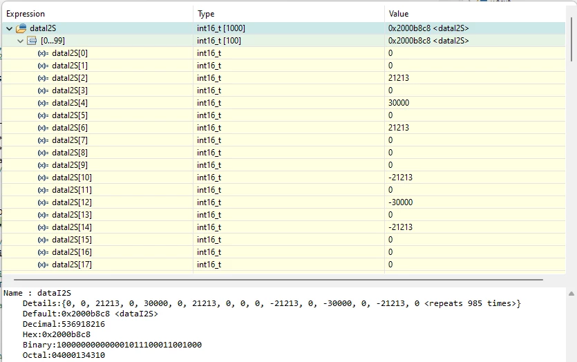

Show here your dataI2S array values for example first ten values as in memory debuger screenshot...

Here are screenshots of the oscilloscope for both sides L and R:

for output same signals need data be equal [0]=[1] [2]=[3]
and too need check BSP support for 16bit data

That’s exactly my point, one side has all zeros but it produces the same exact wave, just time shifted. And the HAL library asks for my data in a 16-bit buffer, so I am pretty sure that means it supports 16-bit data.

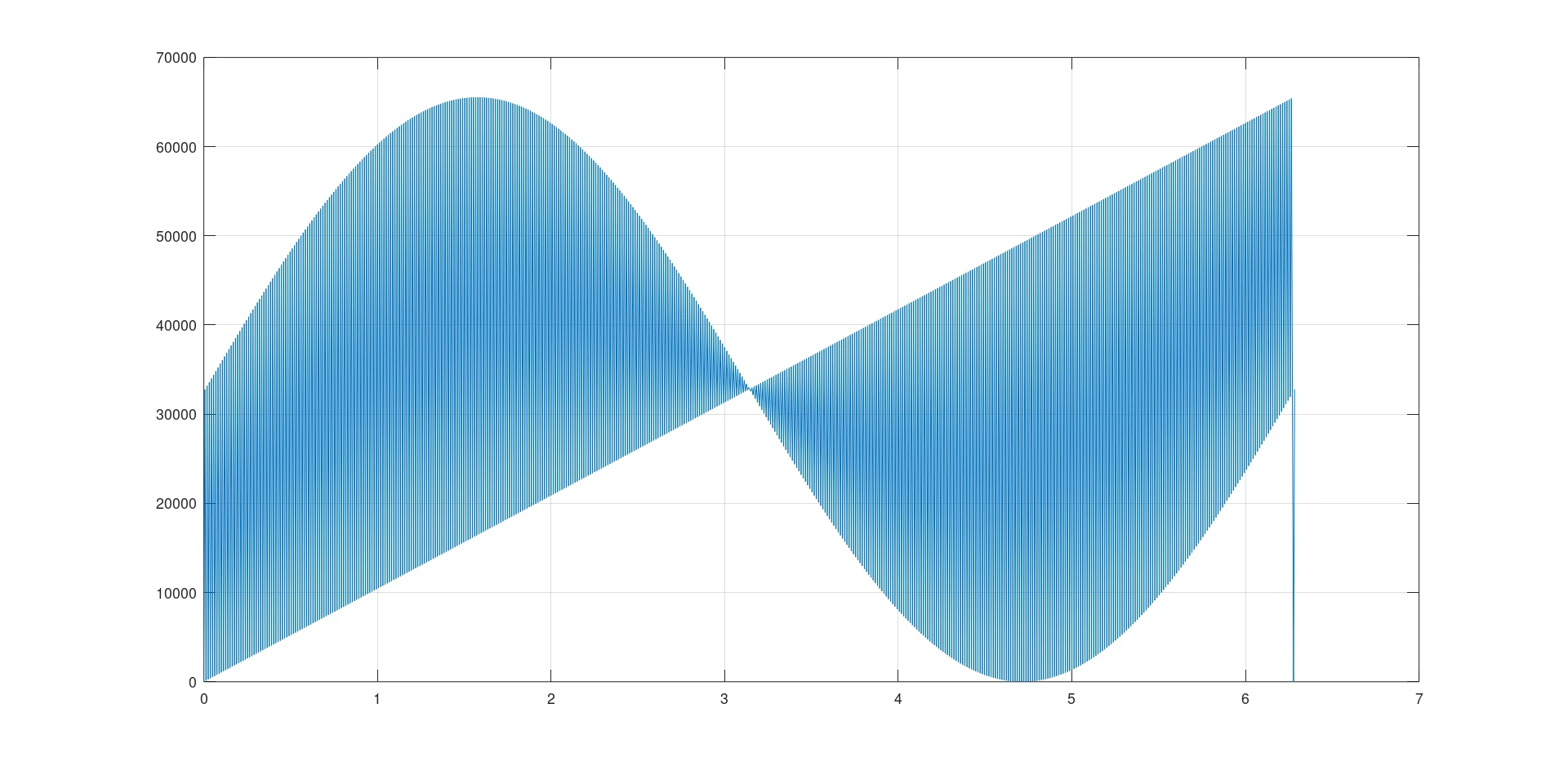

Been a while, but I finally tried your suggestion of a sawtooth wave:
You can see that example below in my oscilloscope capture of the sawtooth wave.
I generated my data in Octave (alternative to MATLAB) and copied over to the STM32 IDE in C. Here are my graphs of a sawtooth and sine wave:
I combine them into one array of 1000 data points with the sawtooth data in the odd indices and the sine data in the even indices:
So, if the stereo sound was truly coming out L for even indices and R for odd indices, we should see a sawtooth on one side and a sine on the other side. The data being fed into the wave is good based on the graphs above! This is what I get when I run on one side on the STM board, however:
I think this looks similar to the last picture where all the data is graphed, so maybe it's trying to output both the sine and the sawtooth wave at the same time and the codec is filtering or smoothing it out?
Here is what it looks like with just a sawtooth data in the indices:
So I am back to my original issue. I can output a single waveform on both left and right. I cannot make left and right independent. I hope it's a simple misunderstanding on my part of how to do this, or something that I need to configure, and not a limitation of the technote on the Discovery board.

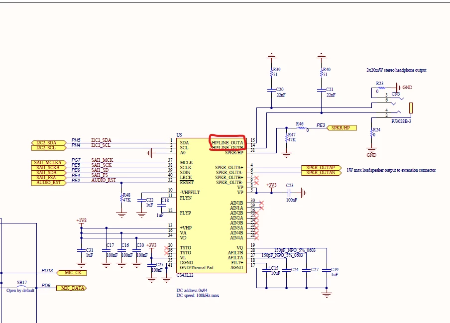

Piranha
Principal III
Jan 15, 2022 3:38 PM UTC
> Do you have any good resources that I can use to learn more about SAI?
MCU's reference manual.
> How do I tell my codec / SAI config where to get R data and L data from?
Again - read the DAC's datasheet! Section "7.22 PCM Channel Swap" shows it.
> Can one have two different things playing out the Left and Right side simply by putting the Left data in odd indicies and the Right data in even indicies on the same buffer?
Yes, channels are independent, but the left channel comes the first and therefore sits at even indexes because indexes of the C language arrays and SAI slots are zero-based. And again - datasheet section "4.7 Digital Interface Formats" shows it clearly.
> The biggest question that I have is, am I approaching the theory of stereo audio right with my buffer?
Not reading documentation and doing blind guessing definitely is not the right approach... ;)
