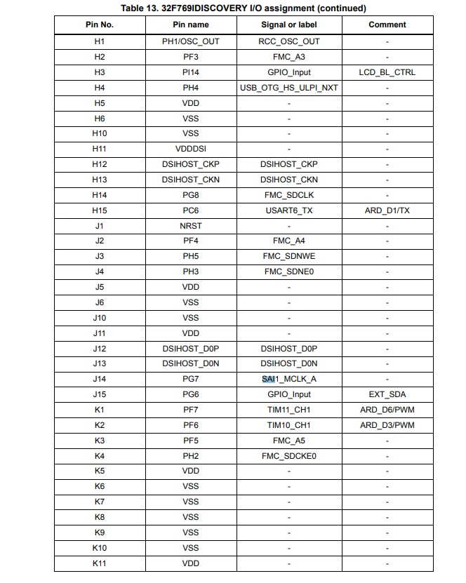

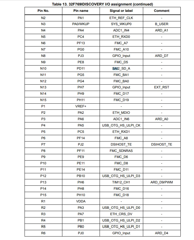

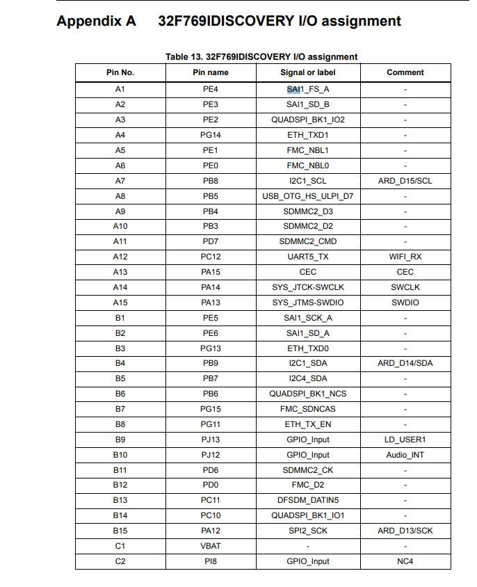

I need to know what data items need to used in the C source code. Are they derived from Signal or Label items in the table shown ?
