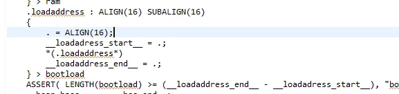

how can I put the boot function at the absolute address
Posted on June 11, 2018 at 12:44
Hello everyone?
I have an issue with bootLoader development?I have debug the bootLoader successfully with SPC560P44, but I am not quite sure about how to jump to bootloader from the application program?
our conventional method is putting the boot function at  the absolute address?and we can jump to bootloader by call the function pointer?but in the SPC5Studio we don't know how to put the function at the absolute address?Can anyone know this ?Appreciate
to receive your reply?

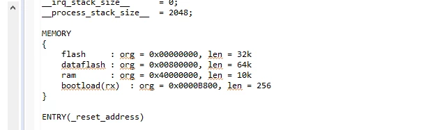

Hello Procolo?
 Thank you for your reply?I have jumped successfully from bootloader to application program?and it was run well?but I have problems jumping form APP to bootloader which has a function located at 0xb800?I used the same jumping function. and I could find it already jumped to the address 0xb800 through the PC pointer?however it seems failed at the initialization func ?and the PC pointer stop at 0x00000c14 which was put the vectors seen from the map doc.
SPC5_CLOCK_FAILURE_HOOK();
and I found  it was really curious that if I close everything in APP ,only the jump func left , it  could jump successfully. Is there any connections between the PC pointer  address which the  jump func located and the aim bootloader func address which I need to jump to?Do I describe clearly?I need your help?thank you so much again?
linker file
destination
the jump code

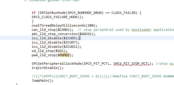

      I have copied your code when I jump,but it did‘t work, I disabled all the peripheral and find that the if the  adc_lld_stop_conversion(&ADCD1); was disabled ,then it worked。But if I tired more ,I found it did not run successfully everytime, I traced the PC in CPU window ,found that the PC was sometimes in IVOR6 or sometimes in IVOR1,what should I do to find the problem?many thanksï¼�

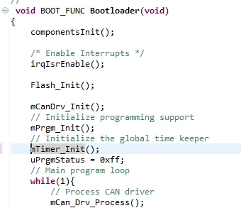

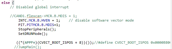

      I think I have disabled the interrupts after

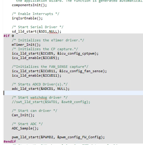

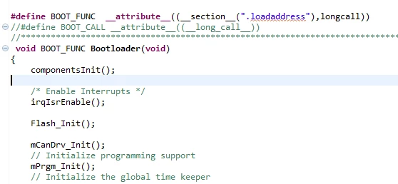

stopping peripherals?but it still entered the IVOR6,  I can?t find where the problem is?here are my application code and the bootloader code? I copy the code from your answers?and is I don't init any
peripherals
 in app? it can jump successfully? it is so weird. There are only peripherals of  can and timer.

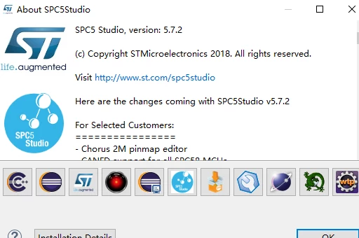

let's investigate. I need the following infomation, could you please provide them?:
  • Version of SPC5studio using (Help-->About SPC5studio)

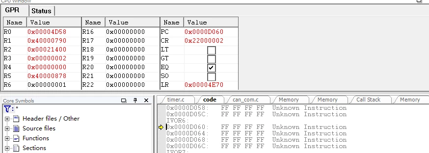

Hello procolo?
   Here are the pictures
1. Version of SPC5studio
2. ivor6 but sometimes it seems to enter ivor1 after jump

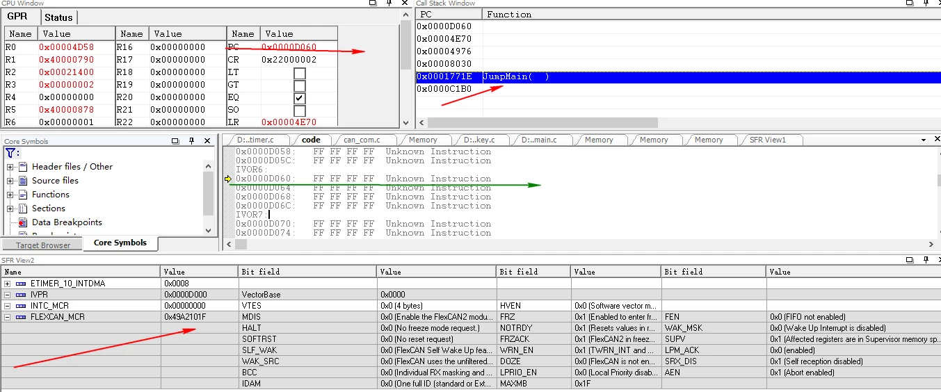

could you try to update spc5studio to 5.8? in alternative you can change can_lld.c with the one attached (there is a new instruction in can_lld_stop).
Moreover, can you send the callstack window in UDE when IVOR occurs (views-->call stack window) and flexcan MCR register value (views->sfr view-> right click->browse)?

Hello procolo?
                  I will try the second scheme?here is my callstack and flexcan MCR register.0690X0000060LGHQA2.png

Hello procolo:
   so much thanks for your kindly help,my problem has been solved ,it was the IVORS didn't been initialized correctly after jump to the bootloader.
