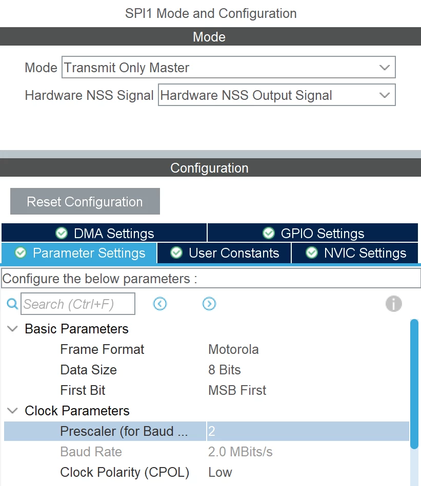

How can I interface an LCD with an STM32L412RBT6P microcontroller using SPI and DMA?
I have an STM32L412RBT6P microcontroller and a CFAG12864T3-NFH LCD which uses an ST7565 controller. I want to use SPI to communicate with the LCD and leverage DMA to efficiently transfer data with lowest current consumption possible. Could someone provide an example code or any helping notes on how to set this up? Specifically, I'm looking for:
1. Initializing the SPI peripheral on the STM32L412RBT6P for communication with the ST7565 controller.
2. Configuring DMA to handle data transfers from memory to the SPI peripheral.
3. Sending initialization commands and data to the LCD with ST7565.
Any help would be greatly appreciated!

1. I mean no SPI clock is based on PCLK2 then in transfer time PCLK must be 2x SPI speed. After transfer can swith down...
2. Too NO.
3. Use partial update method for screen and switch to low power after transfer changes.
By energy law is irelevant if you use low SPI speed with low current long time vs high speed short time. Avoid animation at all.

Actually, I have used this library before and successfully got the LCD working with the MCU, and it's still functioning well with a CPU clock of 16 MHz. However, my application is focused on low power consumption, which is why I am trying to reduce the clock frequency to 1 MHz or even lower.
When I lower the clock speed, the system continues to operate correctly, but the text on the LCD becomes difficult to read and lacks fluency. After some research, I found that using DMA to handle the LCD could allow the CPU to enter low-power modes while the DMA manages the display updates. This approach seems like it could help maintain the performance of the display even at reduced clock speeds.
Do you have any further insights on implementing DMA for this purpose, or suggestions on other methods to optimize the display performance for low-power applications?

As first in normal run mode create display flush with SPI and DMA. After this work handle switch into low power modes with SPI ... supported is only Sleep , LP Run and LP Sleep. Read STM32L4 and STM32L4+ ultra-low-power features overview
