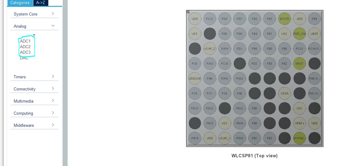

Javier1
Principal
May 23, 2022 11:48 AM UTC
STM32F446 has Maaaaaaany ADC channels distributed into 3 different ADC periprherals.0693W00000NqTlbQAF.png
