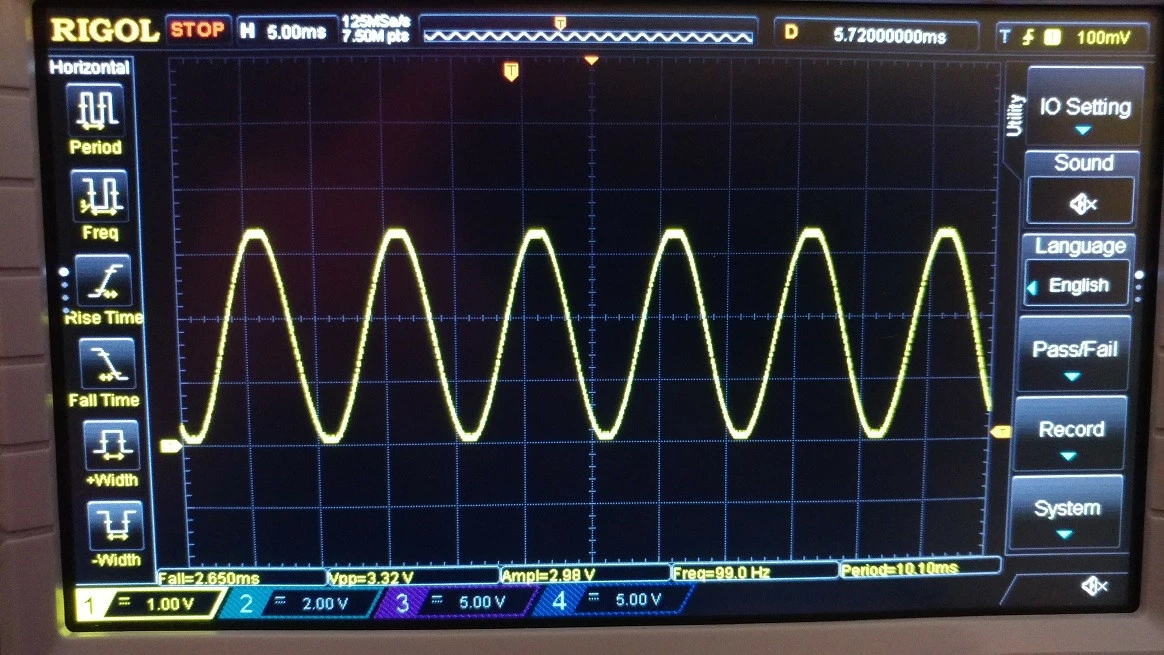

I have the code I used to generate the sine wave according to the doc along with my scope pic

The clock for TIM6 is at 80Mhz. The prescalar is 80-1, the period is 100-1, and the #samples is 100. So 80Mhz/(80 * 100 * 100) = 100Hz.
Here is the picture of the sine wave I generated at 100 Hz

Hi. Thanks for the response. I should mention the sine wave was able to produce an audible tone.
I forgot to mention it is already in buffered mode. You are right, I shouldn't have left A- floating, I connected it to GND as it's ground or a 2nd output line which I don't have in this case. It basically just made the speaker louder.
