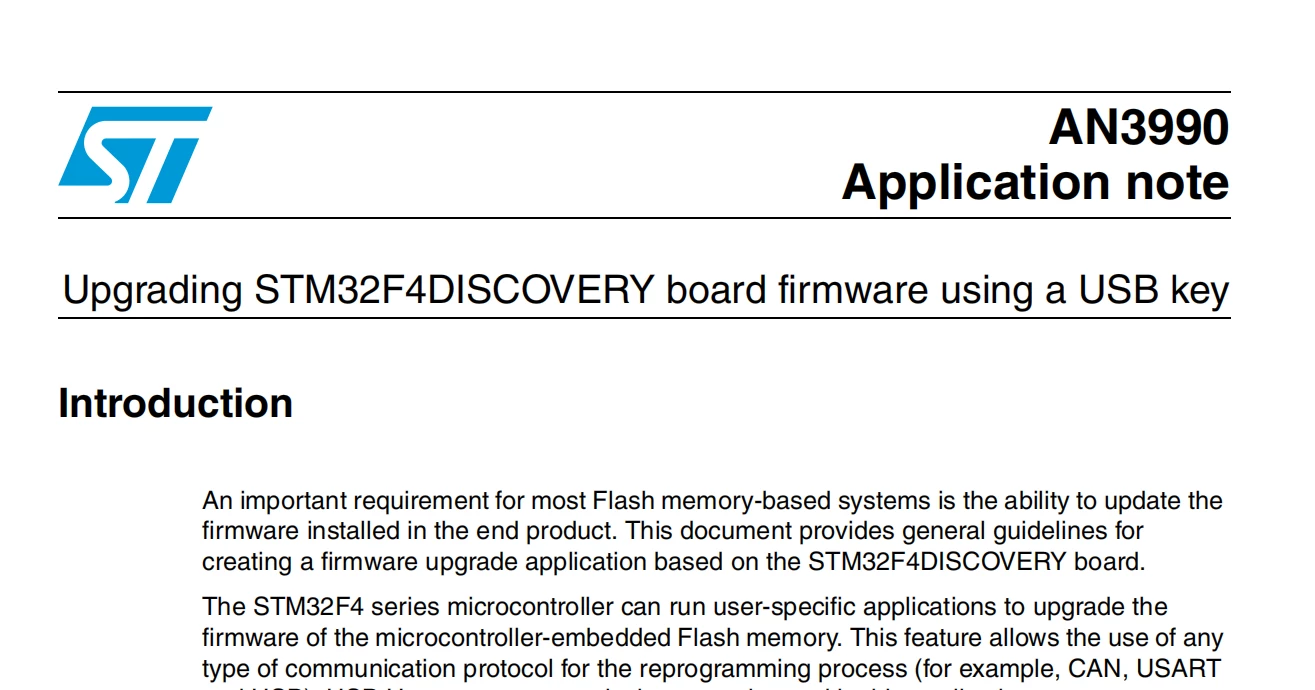

I want to know if have source code about  the upgrade firmware on STM32F4DISCOVERY?
Thanks!

It was in the SPL package for the F4 Discovery. Might be an equivalent in the CubeF4 repository for the board also.​
Tesla DeLorean
Guru
November 1, 2019
STM32Cube_FW_F4_V1.24.0\Projects\STM32F4-Discovery\Applications\FatFs\FatFs_USBDisk\readme.txt
https://www.st.com/en/embedded-software/stsw-stm32068.html
en.stsw-stm32068.zip\STM32F4-Discovery_FW_V1.1.0\Project\FW_upgrade
