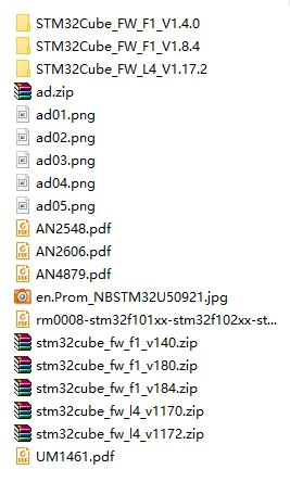

BLu.1
BLu.1Author
October 3, 2022
Thanks for your information, but I don't find some samples here:0693W00000UnEJKQA3.png​Thanks
Boone
Tesla DeLorean
Guru
October 3, 2022
Go down a few directories
Repository\STM32Cube_FW_F1_V1.8.3\Projects\STM32F103RB-Nucleo\Examples\SPI\SPI_FullDuplex_ComPolling
Repository\STM32Cube_FW_F1_V1.8.3\Projects\STM32F103RB-Nucleo\Applications\USB_Device\HID_Standalone
Suggest you get a better File Manager and search/viewer tools.
>>How can I find a sample that read ADC with SPI at 1K speed and send data by USB to PC?
That's a bit specific. These libraries don't come with all possible use cases prebuilt and enumerated,that's usually the job of the embedded software engineer to do, and to combine/modify simpler examples to suit.
