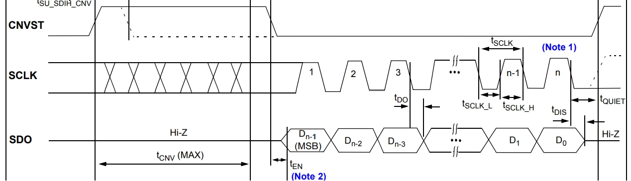

    Hallo everyone,
As a relative newbe in the world of MCU programming, I am searching for an acceptable solution for the fast readout of an ADC chip with a SPI interface. It concerns the MCP33131D/10 ADC (16bit, 1MS/s) to be controlled by a STM32F401CCu Blackpill MCU.
The ADC SPI works slightly different from the standard SPI protocol: the normally used "CS-not" is named 'CONVST' (CONVersion STart), which controls the 'start acquisition' by its rising edge and signals 'data-available' by its falling edge. As this pulse is produced by the MCU, the 'data-available' is not signaled by the ADC, but must predicted by the program (datasheet: >= 1us after the rising edge).
My application should digitize an analog signal every 8us, meaning the CONVST signal must be high during 1 ... 1.5us with a rep-rate of 8us or 125kHz. My first design was the use of a PWM timer signal with a period of 8us and a 1.25us pulse. The interrupt condition 'pulse falling edge' should fire 'PWM_PulseFinished', that invokes the readout of the bytes by 'HAL_SPI_Receive()'.
During my searches on the internet for information around my plan I read a reply of an experienced programmer who stated that even a well-designed ISR will need several hundred clock-ticks to execute. In my case (with a 84MHz clock), this means ~4-5us. So my plan looks feasible, but will require very efficient programming and leaves very little room for other tasks (like exporting the collected data to an USB port). Is this method a way to go or are there better solutions?
I also considered the use of DMA for reading the data from the SPI-bus, but have no clue how to organize this approach in code. The SPI interface must start reading after detection of the falling edge of a Timer PWM signal. After that the two bytes must be transferred to the correct entry in the global data-array. And finally, the program must be informed when the whole array has received new values, so the data export can be started. I think to know a solution for the data dumping (resembles a situation I handled earlier), but I have no idea how to tackle the other tasks.
I sincerely hope there are experienced members of this forum, willing to think with me for a feasible solution for this case. Any advise and/or comment will be highly appreciated,

There are multiple ways to achieve this. The interrupt approach you outlined could work with some efficient coding as you say.
There are also ways to achieve this using DMA in the background that will not require CPU resources. Consider the following solution:
  • Set up SPI1 in master mode, 16-bit transfers.
  • Set up SPI1 reception to go into a circular DMA buffer.
  • Set up another DMA to transfer a 16-bit value (any value) into SPI1->DR when TIM1_CH1 goes low.
  • Set up TIM1_CH1 in PWM mode to produce the CNVST pulse at the desired period and duty cycle.
  • Once you start TIM1, this should all occur in the background. Use the half- and full-transfer complete flags/interrupts to process the data in the first and second half of the buffers.
For reference, here is the waveform you need. TIM1_CH1 will be CONVST. SPI1_SCK is SCLK, SPI1_MISO is SDO.
I would recommend working with registers directly for this instead of using HAL. The reference manual will be your friend here.
