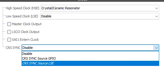

     second, the CRS SYNC Source USB does not show up and if don't use an external oscillator the USB is not available at all.

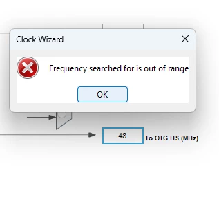

    and last but not the least, if I try to setup the clock with values different from 16,20,24,26 and 32 Mhz I get this error (why this happens is documented in RM0456 but I don't know what should I do)
    Also the board I am working on is the NUCLEO-U5A5ZJ-Q not U575
