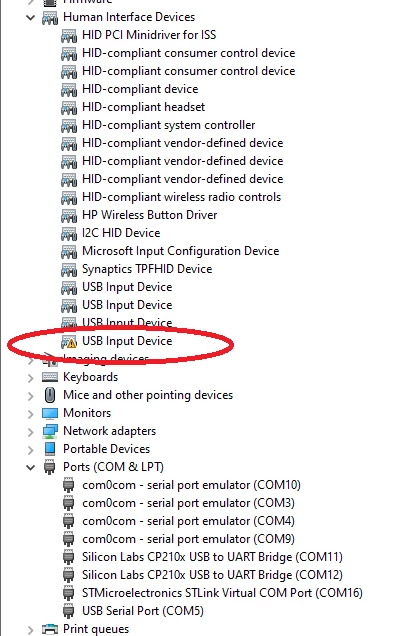

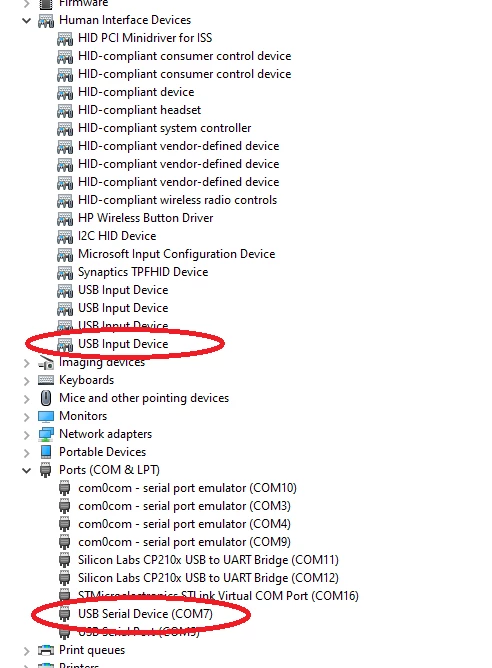

I saw that people were reporting a lot of problems creating a composite device via Cube/HAL. So, in order to test a composite out I downloaded the USB/STD Peripheral library
en.stm32_f105-07_f2_f4_usb-host-device_lib.zip. These examples target eval boards. I only have a STM32F469i-Disco board so I adapted them.
I have attached a cut down version for you to look at.
After reflashing or power up the composite device works ok, see HID_CDC_Test1.png. If the USB cable is removed and re-inserted
the hid device no longer works and the CDC does not appear at all. A restart will cure this. see HID_CDC_Test2.png.

I managed to get this working. I discovered that usbd_cdc_Init() (...\Libraries\STM32_USB_Device_Library\Class\cdc\src\usbd_cdc_core.c) was overwriting the device descriptor. It didn't matter if it was a standalone CDC but after first initialisation of a composite device the overwrite occurs.
