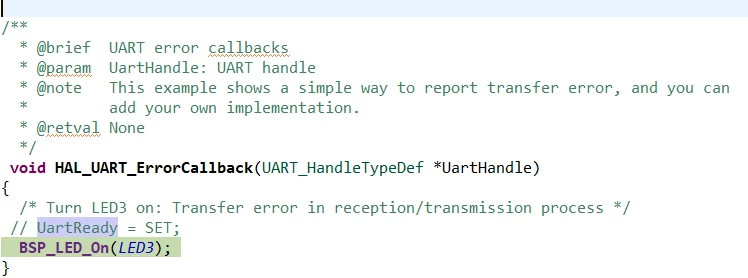

Hi, I am trying to communicate Uart in interrupt mode.We are able to successfully transmit & receive data to PC (through USB-UART).But when we connect to UART based modem then we are getting HAL_UART_ErrorCallback & transmission is failing. Pls help

This error callback function is not getting called when we connect to PC. But we are getting during modem (UART based)communication only. Whats purpose of this callback ? Is there any configuration need to add ?

Which STM32?
There's an error code in huart->ErrorCode indicating the type of error.
/** @defgroup UART_Error_Code UART Error Code
 * @brief UART Error Code
#define HAL_UART_ERROR_NONE 0x00000000U /*!< No error */
#define HAL_UART_ERROR_PE 0x00000001U /*!< Parity error */
#define HAL_UART_ERROR_NE 0x00000002U /*!< Noise error */
#define HAL_UART_ERROR_FE 0x00000004U /*!< Frame error */
#define HAL_UART_ERROR_ORE 0x00000008U /*!< Overrun error */
#define HAL_UART_ERROR_DMA 0x00000010U /*!< DMA transfer error */
Does the modem's baudrate match the STM32's one? Observe Rx and Tx using oscilloscope.

I am trying to communicate with gsm module and it’s getting overrun error in TX call back function. Our uart transmit and receive line is 3.3 v ....We are setting converter for ttl match and result is same.
Please guide us how we can resolve this issue? We are using STM32F411VE discovery.

"it’s getting overrun error in TX call back"
Really - in the TX callback?
Overrun would normally be expected on RX

Then you have to speed up your reception. If system clock is not at max, increase it; if baudrate can be changed, decrease it; if compiler optimization is off, switch it on; if you don't use DMA, start using it.

"But when we connect to UART based modem then we are getting HAL_UART_ErrorCallback" ... "it’s getting overrun error"
As @Community member​ says, that's because you're not handling the received characters quickly enough - possibly (probably?) because you're trying to do too much in your handler.
Thing about it: when you type characters manually, you're only getting a few per second max - so the MCU has plenty of time to handle them.
But a modem can send characters back-to-back - so you need to be quick.
You should be able to demonstrate that by pasting stuff into your terminal, use using its file send facility ...

We have tried new interrupt based program and its working but we still see error and continuously UART error callback function (i.e. HAL_UART_ErrorCallback) getting called.
If this error is getting then we don't get any data in receive buffer. Please suggest us:
  1. How to handle this callback function so that it will clear and start receiving buffer again.
  2. How we can avoid this error ?
Andrew Neil
March 25, 2021
Don't you need to clear the error once you've handled it?

 * @brief UART error callbacks
 * @param UartHandle: UART handle
 * @note This example shows a simple way to report transfer error, and you can
 * add your own implementation.
 * @retval None
 void HAL_UART_ErrorCallback(UART_HandleTypeDef *UartHandle)
 /* Turn LED3 on: Transfer error in reception/transmission process */
 // UartReady = SET;
 BSP_LED_On(LED3);

In above code, we have wrote one of the sample uart transmit and receive flow. Please suggest how we can handle error callback.
PBira.1
PBira.1Author
March 26, 2021
After running initial command successfully then we start getting transmit error(callback) each time and failed to get receive data. Please help us to resolve this issue.
Andrew Neil
March 29, 2021
"getting transmit error"
Which error(s), exactly, are you getting ?

We are getting overrun error.

Hello
In the above code if rx wait loop completed without timeout then NumStage will get the value 2 but this case "case 2:" never implemented .
