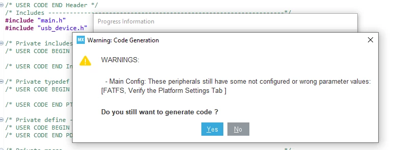

NNK
NNKAuthor
Oct 4, 2022 12:32 PM UTC
It returns the following error when trying to connect over CubeIDE
