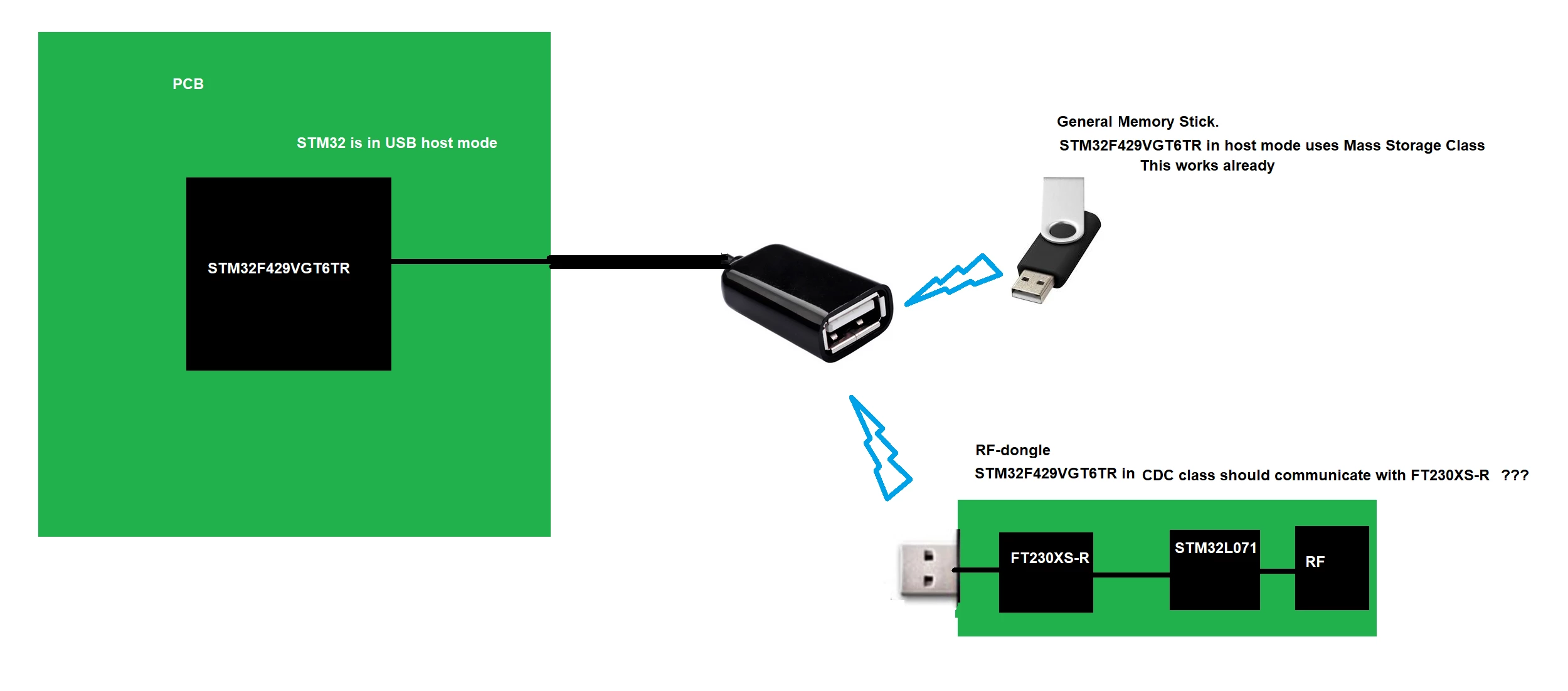

Hi all, Is it possible to communicate between a STM32F429VGT6 in USB Host mode with a FTDI FT230XS chip?
We have already a product based on STM32F429VGT6 which uses USB Host feature to read out data from plugged in USB-memory sticks. Our device have an USB A input so that normal USB-sticks can be inserted.
This works well.
Now there is an USB-stick which is going to transfer data via a FTDI FT230XS chip.
The STM32F429VGT6 needs to communicatie with this chip.
Should that be possible?
Is there already software which does that?

Aug 3, 2020 11:39 PM UTC
FT230X is a USB to UART bridge. How is it communicating with the USB drive? I don't understand the system architecture you're describing.
HPiel.1
HPiel.1Author
Aug 4, 2020 7:44 AM UTC
Hi TDK,
Too clearify my question, I have the following setup:
So option 1 is that the hostprocessor STM32F429VGT6 reads the data from a normal memory stick.
This works already.
Option 2 is that there is already a hardware dongle made with a FT230XS-R chip.
This dongle also needs to communicate with the STM32F429VGT6.
Hope this clarifies my question.
HP
Aug 4, 2020 1:17 PM UTC
Thanks, that clarifies it. Seems possible to me. You'd just need to write firmware to handle a CDC host in addition to the MSC host already there.
