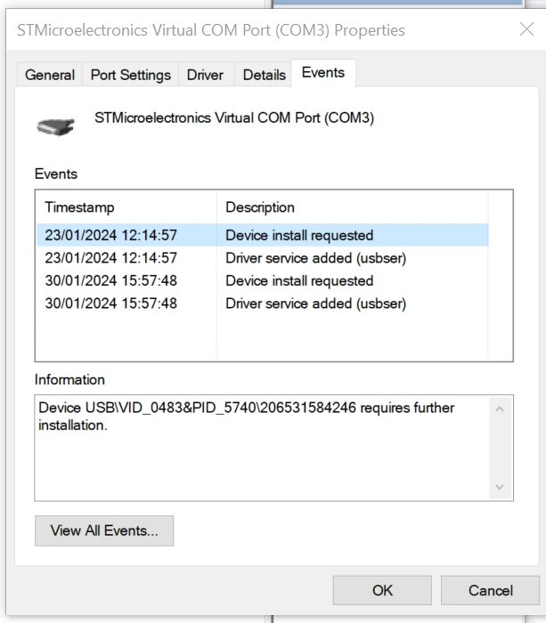

After looking at properties in devcie manager I'm wondering what this means.
I've run the installer downloaded from ST, so that's not it. Windows can't find a better driver.
Lead II
January 31, 2024
This does not mean so much: as long as the VCP COM port driver is happy - it should work.
Windows correctly detected the USB device and the usbser driver claimed it. All this looks good. Is the 206531584246 the "serial number" of your device?
