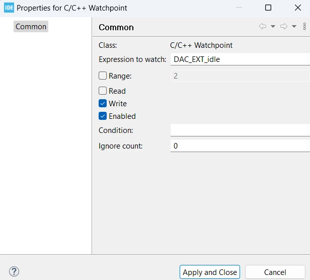

Hi All,
after some struggling, I think I've better pinpointed where the problem is located.
It was not in the Array I originally thought, but in a variable that it is used as alternative source of data, which again  after initial computation should be completely fixed throughout the life of the firmware.
So I have this DAC_EXT_idle uint16_t, and I managed to add watchpoint to that
Surprisingly enough, the breakpoint triggers at this instruction
 /* Clear injected group conversion flag */
 __HAL_ADC_CLEAR_FLAG(hadc, ADC_FLAG_JEOC | ADC_FLAG_JEOS);
which is located in the stm32u5xx_hal_adc.c file in the void HAL_ADC_IRQHandler(ADC_HandleTypeDef *hadc) function, and as far as I can understand, should be completely unrelated to variable DAC_EXT_idle , which is placed in a different file.
I'm wondering if this could be a debug issue?
Any hint would really be appreciated.
Best regards,
Anton
edit:
this is how watchpoint is set up, with or without range enabled I get the same breakpoint
more edit:
culprit probably found, debug correctly pointed the instruction AFTER the problematic one. It was an array writing under interrupt, but array index managed outside the interrupt.
