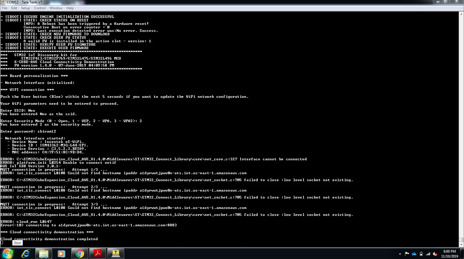

Hello ST team, How to use STM32 IOT Node with ST AWS Dashboard ?? How to connect STM32 to WiFi ??
I'm using STM32L4 IOT Node for industrial IOT project with ST AWS Dashboard.
Going through "Getting started with X-CUBE STM32 Expansion Package For Amazon Web Service IOT" .
According to above PDF, I'm trying to connect to nearby WiFi connection but doesn't connect to WiFi show some Connection Library Fail.
Please find attachment and help me or guide me.

Check the WiFi parameters you typed. The SSID name or the security type (WPA ?) or the password is incorrect.
