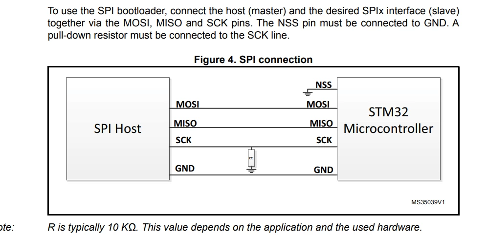

Hello i was reading the "STM32 microcontroller system memory boot mode" documantation and I saw SPI SCK pin pulled down via 10Kohm resistor in SPI connection part. I couldn't see any reason for that. Why SCK pin needs pul down?

You are referring to AN2606, section 4.3, Hardware connection requirements, right?
In order not to interpret interspersed interference pulses as an apparent clock pulse to SCK during periods where SCK is floating, the connection line should be pulled low.

EKOSE.1
EKOSE.1Author
Jan 25, 2023 8:45 PM UTC
Yes i reffered the AN2606. Thanks for your answer. You explained well.
