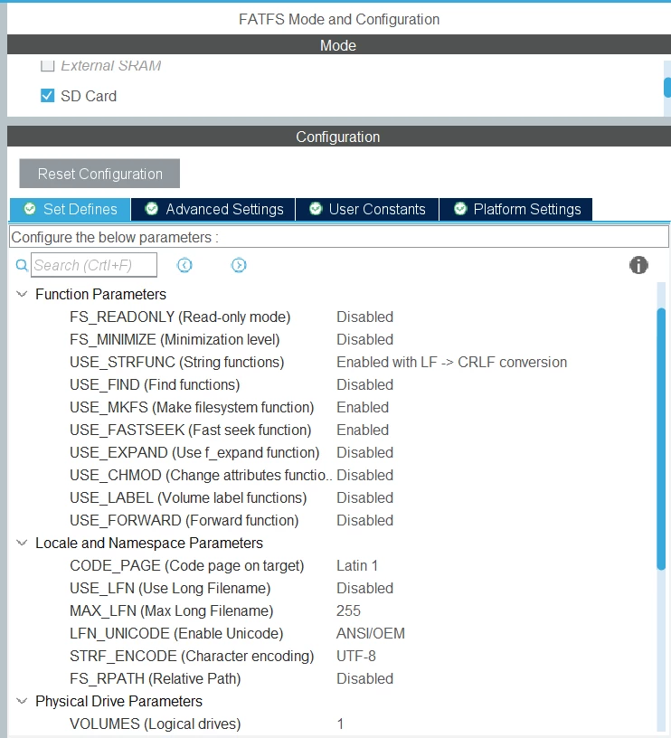

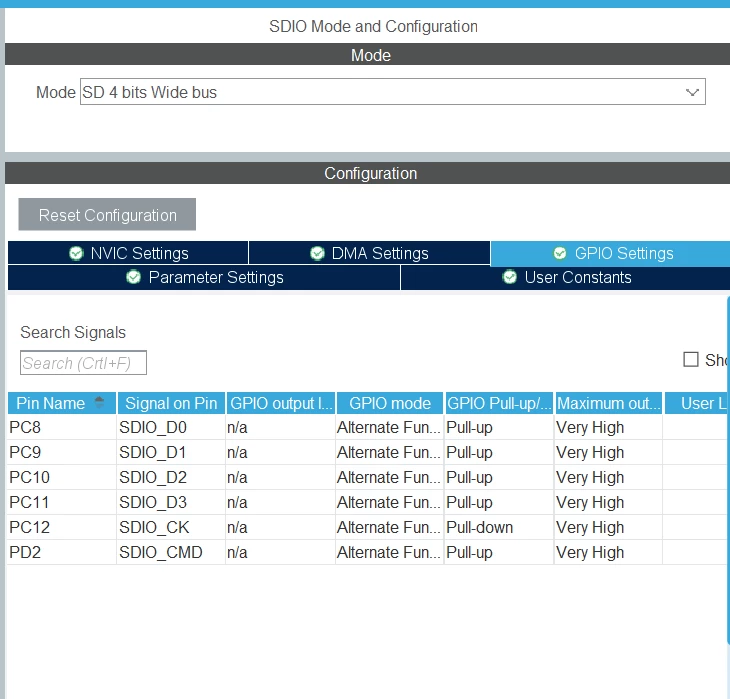

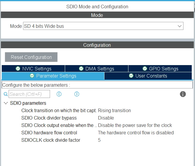

Environment:
STM32CubeIDE 1.8.0
sd card 16gb-class10
configuration in 4 bit mode:
0693W00000SuDWnQAN.pngMinimum heap size 0x200
minimum stack size 0x400
SDIO global interrupt-disable
0693W00000SuDWdQAN.pngFatfs configuration:
the same code work if i generate sdio 1 bit mode with cubeMX .but in 4 bit mode it return FR_NOT_READY

Javier1
Principal
Aug 31, 2022 1:13 PM UTC
did you placed all the pullups?https://community.st.com/s/question/0D50X00009XkfrVSAR/using-internal-pullups-for-sdio-interface

AK.15
AK.15Author
Sep 1, 2022 5:28 AM UTC
Enable internally pull-ups on all lines except sdio _clk
