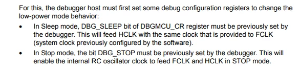

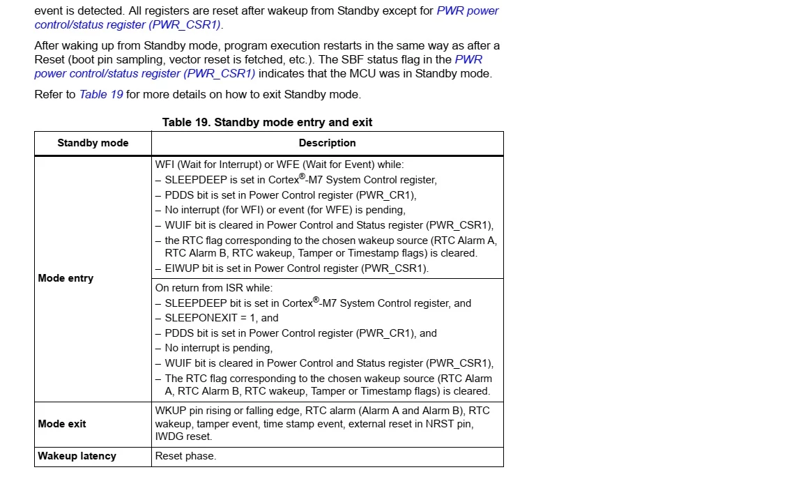

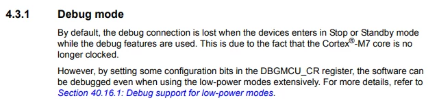

This indicates that the MCU has been reset (a hard fault probably). Could you clarify if you need to restart debugging or that you find yourself in the entry point after exit of the low power mode.
Otherwise, to answer you question here are extracts from the reference manual:

By the way, it's not about HARD FAULT. The question is why does the controller reset when exiting POWER DOWN mode.
Mohamed Aymen HZAMI
Jul 12, 2021 8:39 AM UTC
Hello @Community member​,
For Standby and Shutdown we have a system reset after waking up, otherwise the other modes continue the execution.
