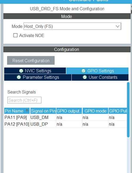

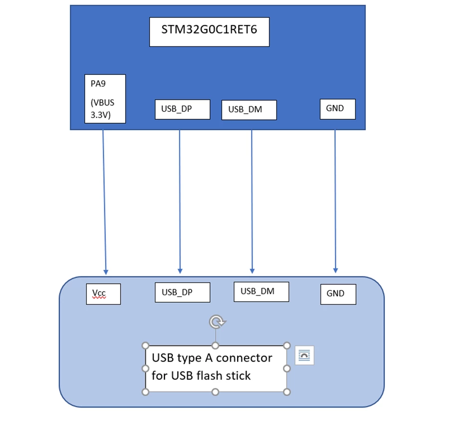

Hello guys, I am working with STM32G0C1RET6. I want to use STM32 as a USB host and want to save data on USB flash stick. I followed some tutorial from ST microcontroller's youtube channel but I am still not able to mount my USB device. what should I
Here are details about my project:
  • I have connected my USB_DM and USB_DP pin directly to USB connector.
  • I enable A9 and selected as a GPIO output using VBUS setting in CUBEIDE. Which is providing me 3.3V
  • I read that there is inbuilt pull up resistor in STM32G0C1RET6. So, I connected USB connector directly to pins
  • I used "f_mount" function to mount my usb device.
My USB device is using FAT32 format. I AM SORRY if I made some dumb mistake; I am newbie

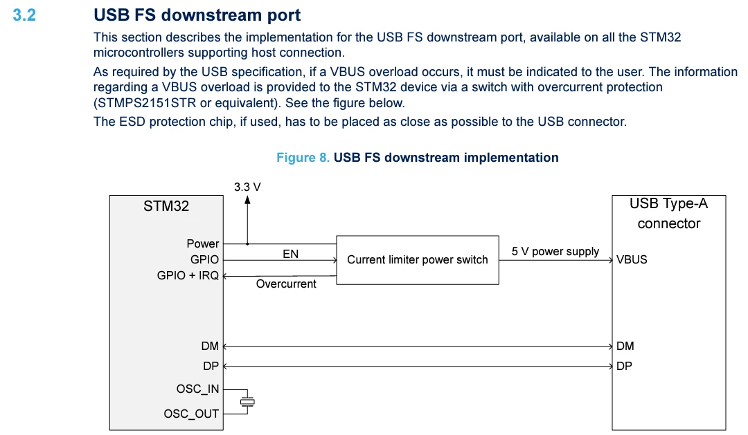

0693W00000NpnHjQAJ.pngIf your USB connection is as above, I recommend that you find the MX_DriverVbusFS function in the usbh_platform.c file and make its content compatible with your power switch IC.
https://www.st.com/resource/en/application_note/dm00296349-usb-hardware-and-pcb-guidelines-using-stm32-mcus-stmicroelectronics.pdf
jsoda.1
jsoda.1Author
May 12, 2022 2:25 AM UTC
Hiii, thank you so much for suggestion. Is it necessary to set USB connection as you showed in image??
I​ didn't make any connection like that. I just connected USB connector pin to STM32's A9 pin.

Muhammed Güler
Senior III
May 12, 2022 3:41 PM UTC
You can use STMPS2141 as switch. I also recommend adding a protection element such as USBLC6-2SC6 to the USB data line.​

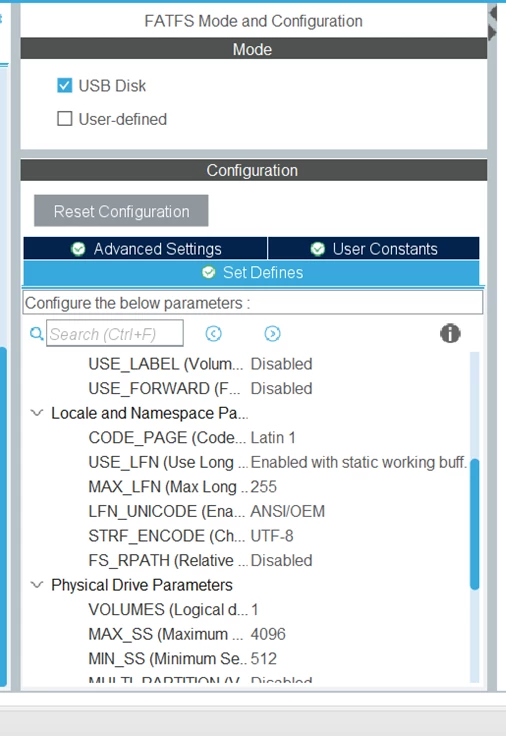

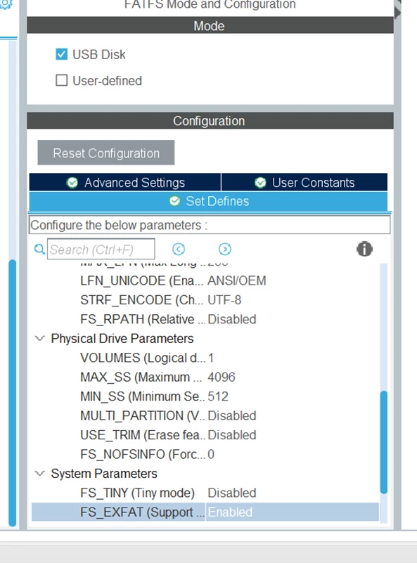

Sorry for bothering you guys again. I have tried to solve DISKIO error but everything is working fine. There are no errors. Can low heap size cause FR_DISK_ERR??
I am posting the code I wrote in "USB_host.c" and my settings which I am using:
Generally speaking GNU/GCC hides a lot of potential size issues with heap/stack
Some of the USB Driver Stack for devices used the heap.
FATFS can use the heap for things like long filenames, etc, check ff_conf.h
It can also use the stack for auto/local variables, I'd typical look for at least 1 or 2 KB
