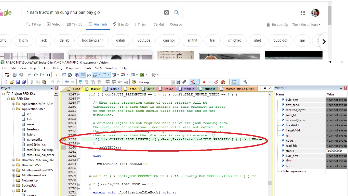

Hello everybody , i send socket and revceive with stm32f407 + lwip + udp by function sendto(), receivefrom(). but when i send about 2.3 minutes everything is stop and stop in task. Help me, thank you so much

Sorry, but there is not much information about your issue, except for guessing.
Perhaps a stack overflow or a buffer overrun ?
Use a debugger to check if the code faults (hardfault handler). If so, decode the respective SCB fault registers.
Instrument your code to see what happens.
