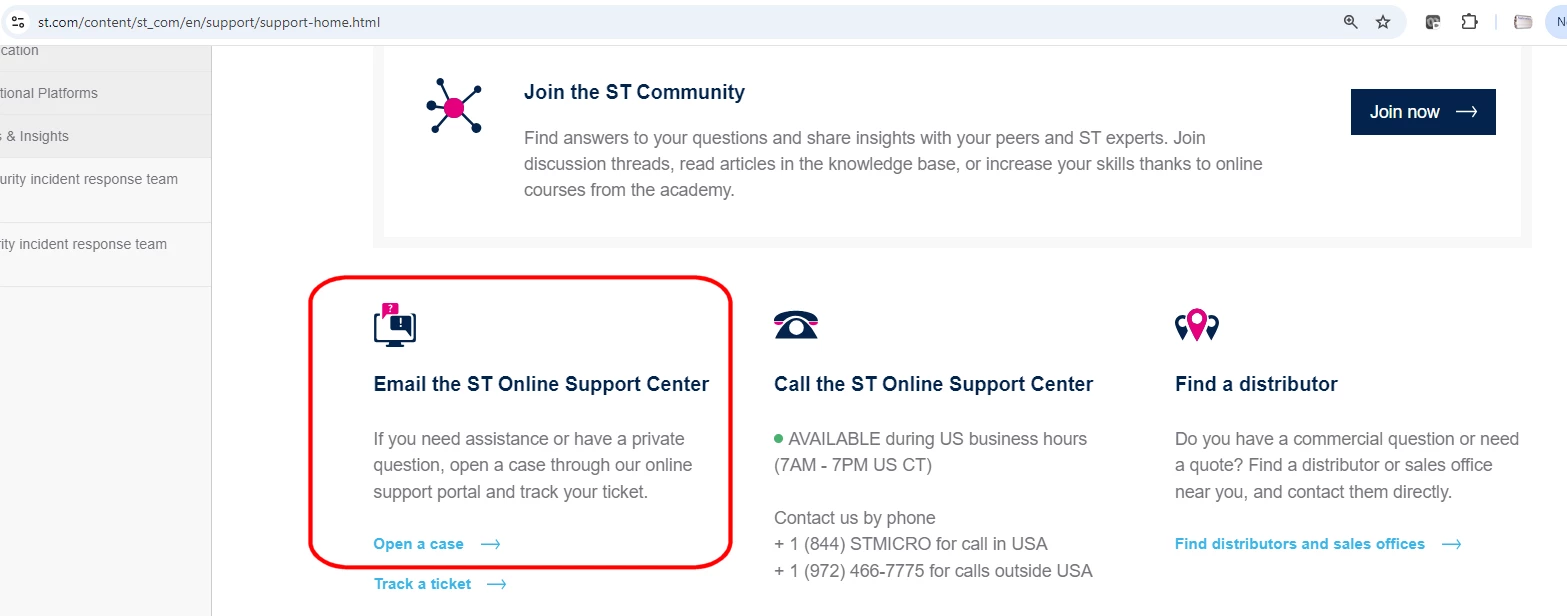

You're posting in the public community.
If you want to contact ST direct, you need to open a Case with the Support Centre:
