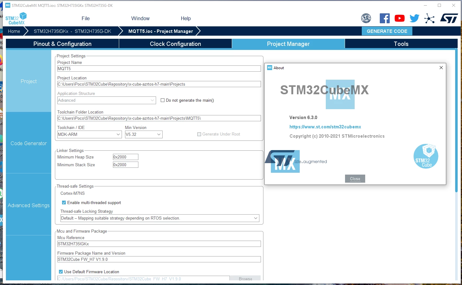

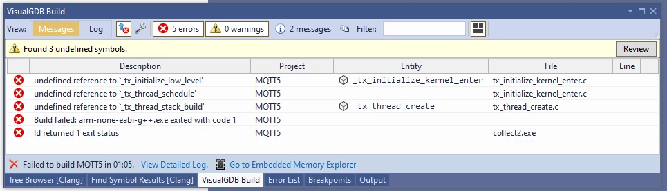

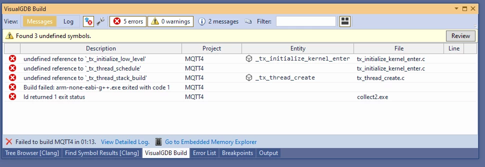

I have done this many times already,
I will start again
I will download RKOUSTMRelease of X-CUBE-AZRTOS-H7 v2.0.1
Which folder should that go ?
C:\Users\Poco\STM32Cube\Repository ?
(not under C:\Users\Poco\STM32Cube\Repository\STM32Cube_FW_H7_V1.9.0)
ok, a fresh download, now Azure 2.0.1 and compile
where is the Cube file ?
why is it not included in the folder ?
ok, generating a new cube file from scratch in this folder, is this correct ?
C:\Users\Poco\STM32Cube\Repository\x-cube-azrtos-h7-main\Projects\STM32H735G-DK\Applications\NetXDuo\Nx_MQTT_Client
Just selecting the board H735, and start project with default peripherals is this correct ?
enabled multi threaded support
OK, selecting a new folder for the new project: is this correct ?
C:\Users\Poco\STM32Cube\Repository\x-cube-azrtos-h7-main\Projects (project name MQTT5)
Generate files
ok, done, Cube file attached
Open Visual Studio
new GDB project
import from Keil
nono with floating point support
and compile
with this result:
0693W00000GX0yQQAT.pngso either way the results are the same,
Yesterday I was following the Getting Started Video and selecting the Azure software set inside the cube
the cube decided to use the Azure 1.0.0 files and it downloaded them to compile and give the fails I reported 2 days ago.
I had to buy the H735-DK to suit that video.
Maybe you can try to reproduce this with a fresh cube file and compile ?
0693W00000GX0zOQAT.pngI hope you can resolve this.
Please give me a step by step on how you load and compile to zero errors.
