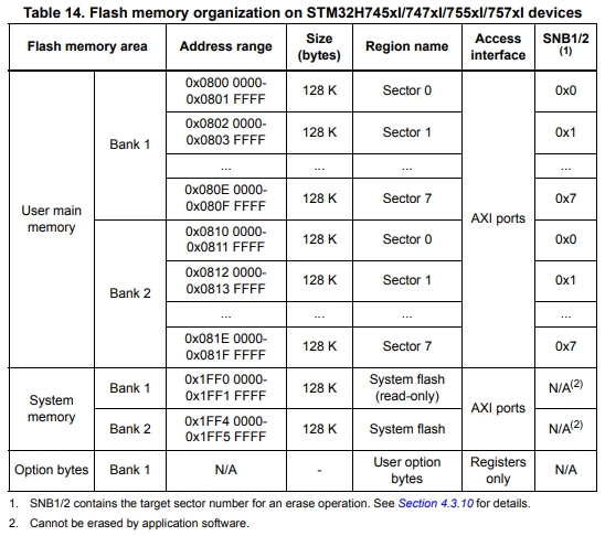

I'm trying to write a struct of size around 680 bytes to Sector 1, Bank 2 of the flash in an STM32H757XIH6. I'm pretty new to this kind of thing so I'm slowly building on the code. I'm using the STM32 HAL driver. The address of this sector is 0x08100000.

3 replies
filipxsikora
January 12, 2025
first of all, H757 is a dual core. And the second core (CM4) has it's ROM starting at exactly 0x08100000. If you left it at default and haven't moved it, you just deleted CM4's ROM from under it's hands which could lead to all sorts of issues and crashes.

gcoardAuthor
January 12, 2025
Interesting, I was just going off this part of the datasheet:
Either way, I've changed the address to 0x08E0000, bank 1 sector 7.
Yes I had the word size a bit wrong, have made some corrections and it appears to be saving the data.

filipxsikora
January 12, 2025
Well flash description from RM is generic, you need to check linker scripts.
