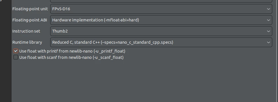

From my research, it seems that I need to disable the --specs=nano.specs option.
However, in the IDE, under Runtime library options, I have the following choices:
  1. Standard C, Standard C++
  2. Standard C, Reduced C++ (--specs=standard_c_nano_cpp.specs)
  3. Reduced C, Standard C++ (--specs=nano_c_standard_cpp.specs)
  4. Reduced C, Reduced C++ (--specs=nano.specs)
With the first option, the compilation fails because it can't find the asserts. I'm currently using the third option, but I encounter a hard fault when exiting the catch block.

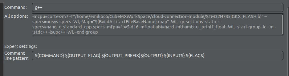

I've tried modifying the makefile, but some script seems to re-include the specs after building.

Use Standard C, Standard C++ to enable exception handling. What asserts can it not find?
Exception handling is typically not used on embedded platforms as it vastly complicates the code.
