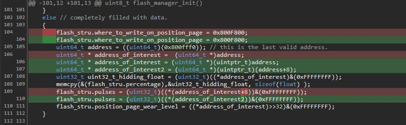

hardfault when reading the flash
Hello
I think I solved the problem but I do not know why. When I try to access the last address of a page it causes a hardfault.

Unwritten memory can fault.
Unaligned memory reads for doubles fault Cortex-M devices.
CM0(+) device will fault unaligned 16, 32 and 64 bit transactions

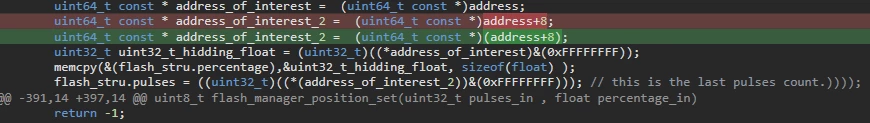

Solved!
I do not comprehend very well  how I solve it but I far as I understand casting integer into an address is not that intuitive as casting float, double or integer among themselves.
