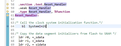

I did find the Reset_Handler and added a breakpoint at the first instruction ( inline asm ) - it never hits this one
either.. ( located in startup_stm32l151vetx.s )
StouferAuthor
Aug 15, 2023 7:17 PM UTC
I placed breakpoints at the following locations - and it goes directly to hardfault_handler and does not hit these breakpoints.

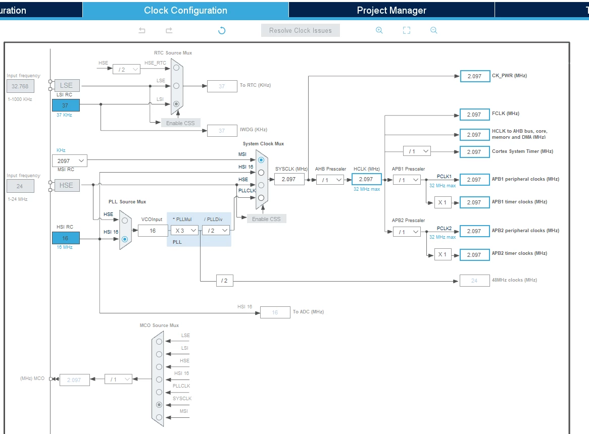

I thought maybe it was that we use an internal clock and maybe the default project it creates expects an  oscillator. But looking at the ioc it looks like its expecting internal
