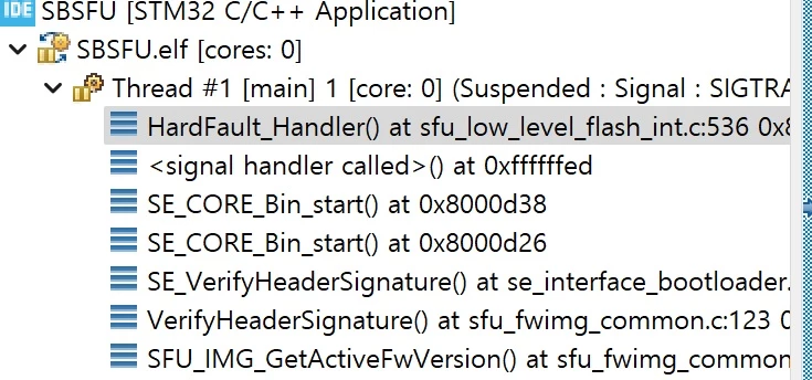

I’m using NUCLEO STM32H753ZI.
I use ST ID: STM32cudeIDE
I have HardFault_Handler when call vTaskStart_Scheduler() using FreeRTOS
Could you please let me know how to resolve this issue?
Below is the sample code

July 11, 2025
Hello @EddiePark
Please refer to the article below to debug hardfault:
How to debug a HardFault on an Arm® Cortex®-M STM3... - STMicroelectronics Community
In order to give better visibility on the answered topics, please click on 'Best answer' on the reply which solved your issue or answered your question. Saket_Om
Pavel A.
July 12, 2025
From the screenshot it looks like SFU software is involved, and the hard fault is expected. Have you tried to continue and let it recover?

Pavel A.
July 12, 2025
Then there's some confusion between the SFU software you're using and FreeRTOS. I am not very familiar with SFU, perhaps it is not compatible with FreeRTOS, or assumes another flavor of FreeRTOS. In plain FreeRTOS the SVC handler vPortSVCHandler is invoked once, to start the scheduler. Here in sfu_se_mpu.s you have something different.
