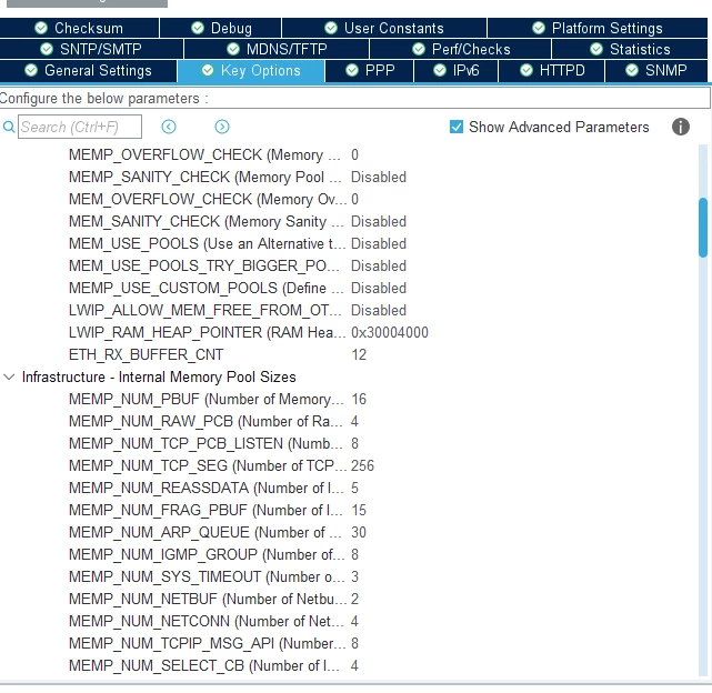

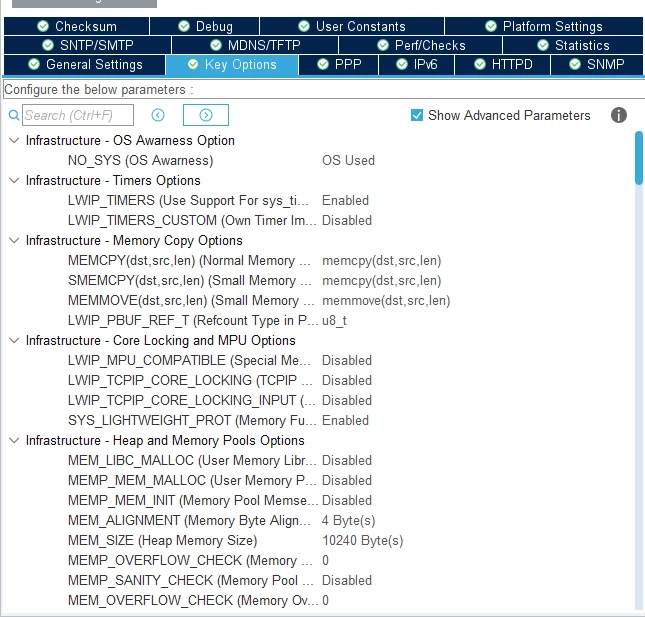

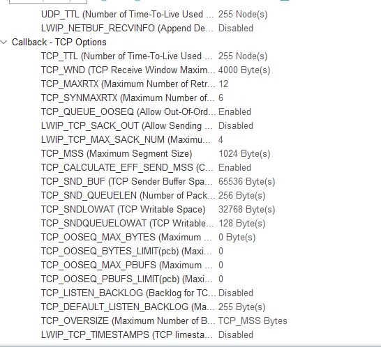

I have put the lwIP heap and pbuf pool into AXI SRAM / D1, maybe try that.
You won't run out of memory that quick - but I have actually no idea how the OS or you are handling the lwIP pool memory...

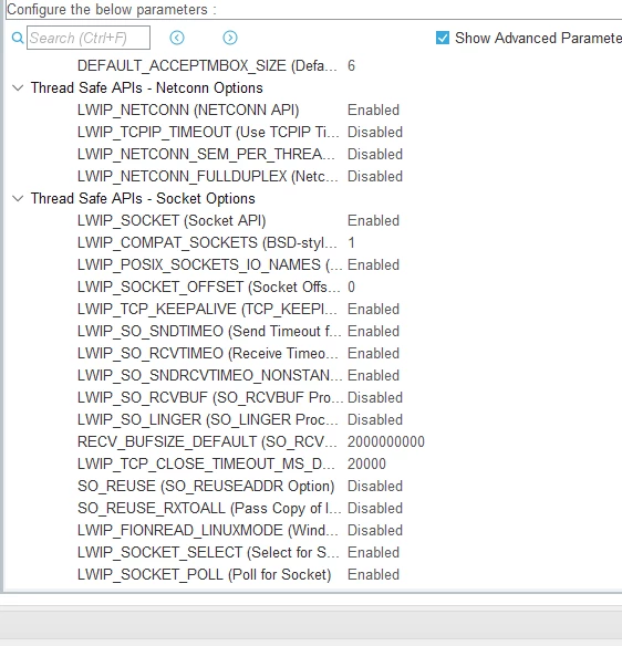

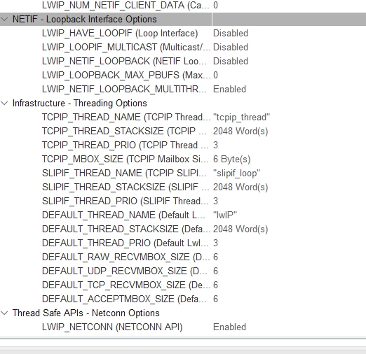

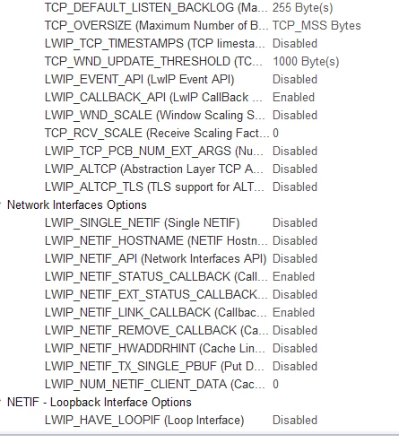

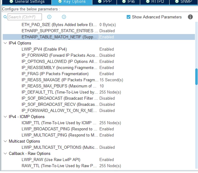

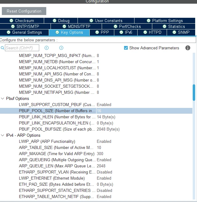

I am working on a project using the STM32H723VGT6 controller with the DP83848VV Ethernet IC (MII interface) and FreeRTOS. I need assistance optimizing the lwipopts file settings to send large data (e.g., 40 KB images) efficiently over Ethernet.
I have attached a screenshot of my current settings, but I believe some values might not be configured correctly. Could you please suggest the best values for key LWIP options like TCP_MSS, TCP_WND, PBUF_POOL_SIZE, etc., to handle large data transmission smoothly? Please suggest the best value and look on the screenshot which I attached.11.png
Thank you for your guidance!
