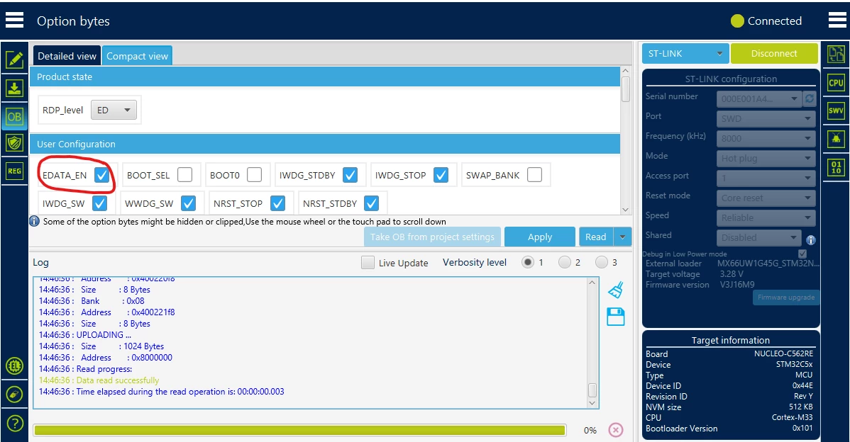

I also checked the EDATA_EN option bit in STM32CubeProgrammer, and it appears to be enabled correctly.
What does this mean, exactly?
Can CubeProgrammer read the data area at 0x0900’0000?
canyldrmAuthor
August 19, 2026
I checked in debug mode that the EDATA_EN bit is set to 1. I also reprogrammed the option bytes, setting it first to 0 and then back to 1.
I can see the data area at 0x0900’0000 there is no error while reading the address 0x0900’0000. All the values are 0xFFFFFFFF.

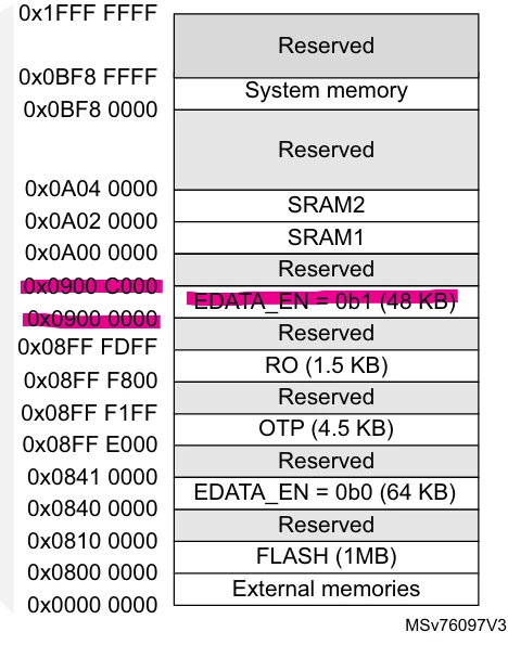

The EDATA region spans the following address range:
and the MPU configuration should be:

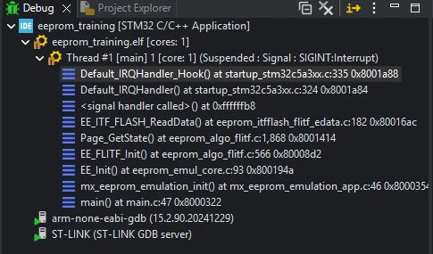

I created a new CubeMX project to avoid the previous issues. I configured the MPU as you mentioned and called mx_eeprom_emulation_init() before entering the while loop.
After running the code, I paused the debugger and noticed that the software was stuck in the Default IRQ Handler. I think I may not have configured the fault handlers correctly, so I couldn't determine the root cause.
Could you please check my latest ioc file?

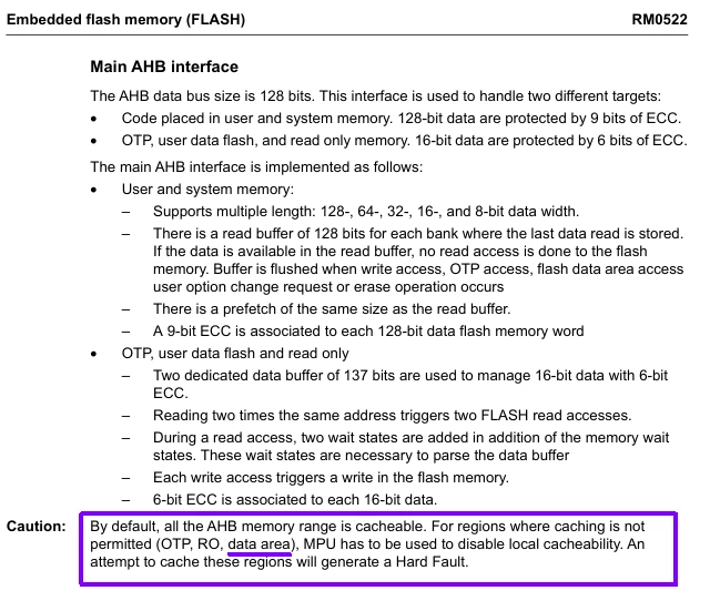

Is this
the reason for setting up the MPU region to mark the 0x0900’0000… area as non-cacheable?
If so, how comes accessing the 0x0840’0000 area (which IMO is “data area”, too, isn’t it?) does not cause hardfault, even if it does not have MPU setup either?
A second question, why does RM say a *Hard Fault* will be generated? Wouldn’t the correct description be, “Bus Fault will be generated (escalated to Hard Fault if Bus Fault is not enabled)”?
