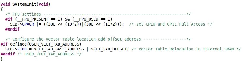

Hi @gbm correct me if I am wrong. SystemInit() is used to set the vector table and has nothing to do with clock configuration and SystemInit() is called in the startup file.

Hi @gbm, @TDK thanks for your inputs. I am referring to this. Which is defined in the system_stm32g4xx.c file by STM32CubeIDE.
@TDK can you please point out which file are you referring to?
