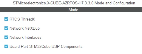

I'm trying to establish a TCP connection between my Nucleo-H753ZI and my PC.
I'm using ThreadX and NetxDuo.
First of all, i'm triggering a hard fault when activating Network Interfaces and then using the debug mode.
I don't seem to have hard fault if i flash the program directly into the board (I have a thread that blinks an LED that still works)
This is my cubeMX configuration :
I installed the following, using the Software Packs Component Selector:
STMicroelectronics-X-CUBE-AZRTOS-H7:
  ThreadX => Core
  NetXDuo => NX Core
  Network Interfaces => Ethernet Interface, Ethernet Phy Interface : LAN8742_Phy_Interface
  Board Part STM32Cube_BSP_Components : ETHPhy / LAN8742

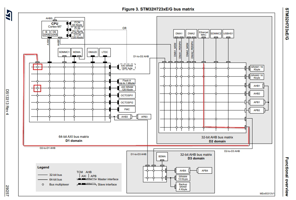

Hi @unkn0wn ,
First of all please make sure that your Ethernet buffers are not in AXI SRAM as Ethernet MAC has no access to it.
Regards,
Dmitry
Haithem Rahmani
Dec 19, 2024 5:08 PM UTC
Hi @DmitryR
Actually, the Ethernet MAC has access to AXI SRAM as shown below in the bus matrix.
the only unaccessible memory is the DTCM.
regards
