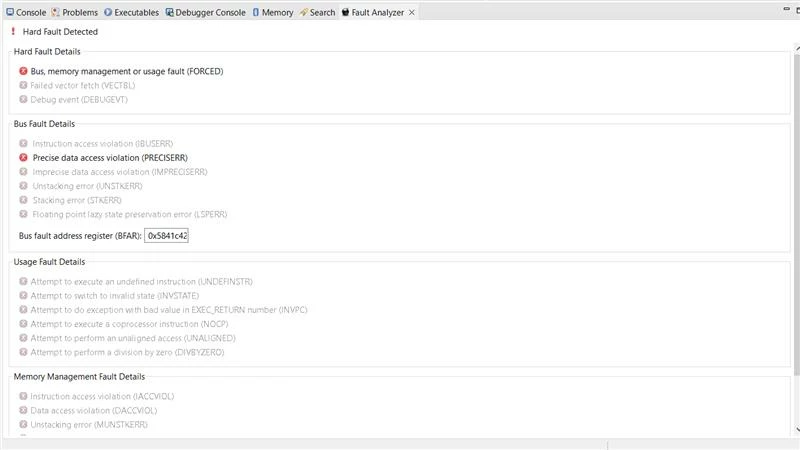

Hello all ,
I am facing a issue of hard fault because of some reason however after analyzing issue I  suspect this could be due to  use of structure having uint64_t variable having bit fielding. I have also attached snapshot of issue which I am facing(Precise data access violation).
typedef struct _st_device_info_payload
 uint64_t IMEI : 50;
 uint64_t BLE_MAC_ID : 48;
 uint64_t WiFi_MAC_ID : 48;
 uint16_t Server_Port;
 uint64_t SIM_ICCID_1 :6;
 uint64_t SIM_ICCID_2 :64;
 char Server_Domain_Name[20];
 char APN[20];
}st_device_info_payload;
Please confirm these few points.
1. Can I use uint64_t for STM32H7 MCU.
2. Can we use bit fielding for uint64_t variable for stm32h7.

Hello @devendra ,
answering your questions:
  1. yes, you can use type uint64 with STM32H7.
  2. use bit fielding for uint64_t variable for any 32 bit device is risky as it can lead to unaligned access which could cause a Hardfault and most probably it's you case.
you need to further pinpoint the exact instruction which lead to the Hardfault to make sure it is a problem of memory alignment so my recommendation is to take a look at this article which will help you debug the Hardfault.
This immediately hints to alignment requirements. 64-bit variables should be aligned on 64 bit even on Cortex-M7.
Bit fields wider than 32 bits ... not sure. Use disassembly view to see how it compiles with your compiler (gcc or IAR or Keil or ??)
