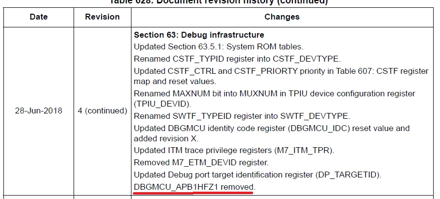

In fact for STM32H743 (RM0433) I’m seeing, the register has been removed from the RM :

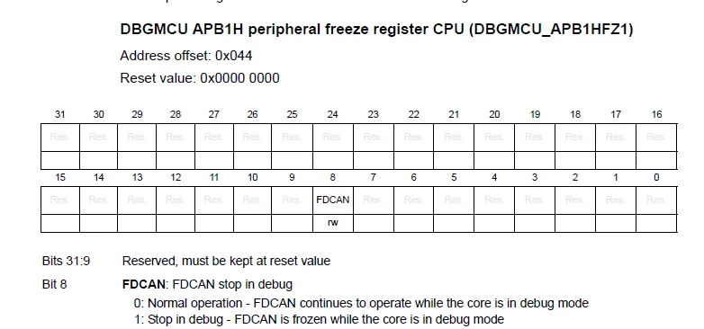

It was available in an old version of RM0433:

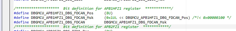

while it’s available in the HAL :
stm32h7xx_hal.h:
stm32h743xx.h:
