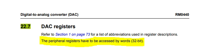

Saket_OmBest answer
Oct 25, 2024 8:13 AM UTC
Hello @rutvik1110
It is mentioned in the reference manual RM0440 that the peripheral registers should be accessed in words.
You can keep MemDataAlignment as DMA_MDATAALIGN_HALFWORD and set the PeriphDataAlignment to DMA_PDATAALIGN_WORD.
Please see the screenshot below from the reference manual.
In order to give better visibility on the answered topics, please click on 'Best answer' on the reply which solved your issue or answered your question. Saket_Om
