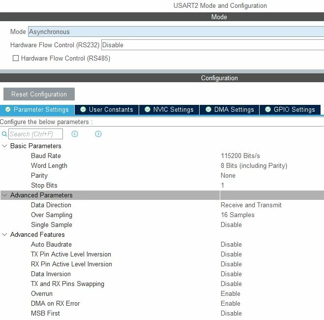

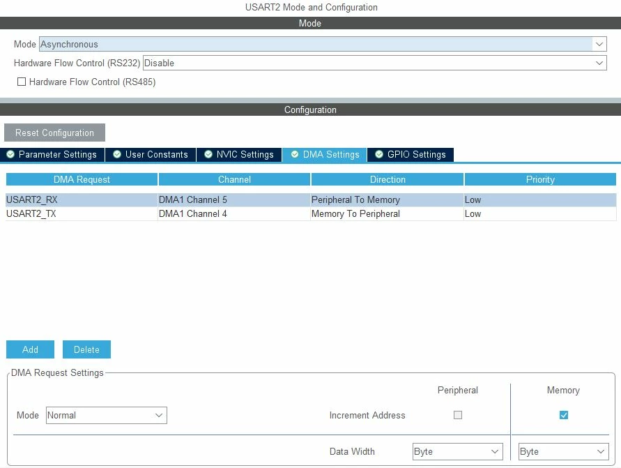

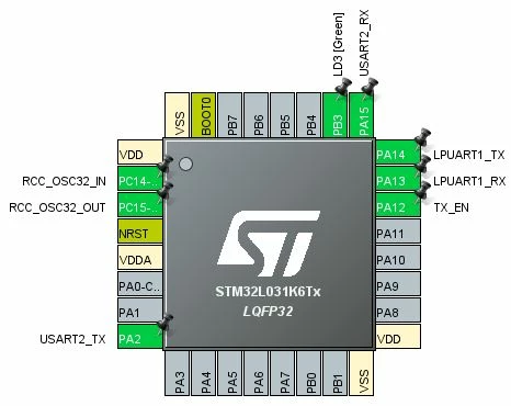

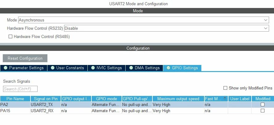

The development board I use: NUCLEO-L031K6
The UART of interest:USART2
So here's my setup:
0693W00000bhDtDQAU.jpg0693W00000bhDtIQAU.jpg0693W00000bhDtNQAU.jpg0693W00000bhDtSQAU.jpg0693W00000bhDtcQAE.jpgI added the following code:

rx_buf_size is set to 16. And exactly after 16 bytes the RxEventCallback gets executed.
What am I missing?

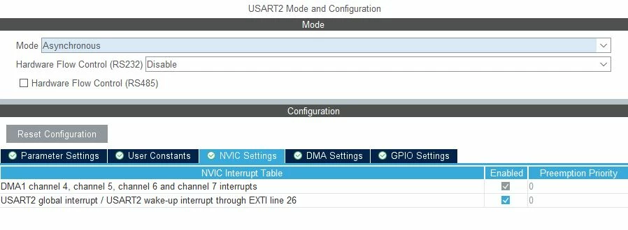

As you can see in my setup, the USART2 global interrupt ist set.
Could somebody point me in the right direction to look for the problem?

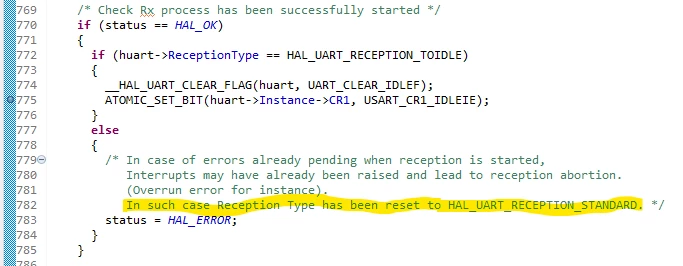

I'd check the HAL status when you call HAL_UARTEx_ReceiveToIdle_DMA. More than likely it returns as HAL_ERROR. So based from the notes i highlighted it reverted to HAL_UART_RECEPTION_STANDARD. That would be the only explanation why you're not getting interrupts on idle.
Check the HALdriver stm32l0xx_hal_uart_ex.c and put a breakpoint on line 775 and see during debug if it breaks.

I assume you're using the VCP? Did you check with an oscilloscope to see if the PC is sending data and you see data activity on PA15? Baud rates match?
If a reply has proven helpful, click on Accept as Solution so that it'll show at top of the post.CAN Jammer an open source CAN bus hacking toolCANableV3 Open Source
Markus Spiekermann
Mar 31, 2023 6:54 AM UTC
Yes, I am using the VCP. And I connected an oscilloscope with decoding functionality to monitor PA15.
The terminal software to send data via serial line is PUTTY. And as I already mentioned, I know that
data has been received, cause after exactly 16 Bytes the callback function gets executed due to
the RxCplt event.

it was not exactly the reason but the right direction. In fact I missed to check the
Status of the HAL between two conscutive called DMA functions.

If the DMA (half)complete callbacks are working, but the IDLE does not, it means the UART interrupt for some reason doesn't work. Stop clicking and check the actual CubeMX generated bloatware.
