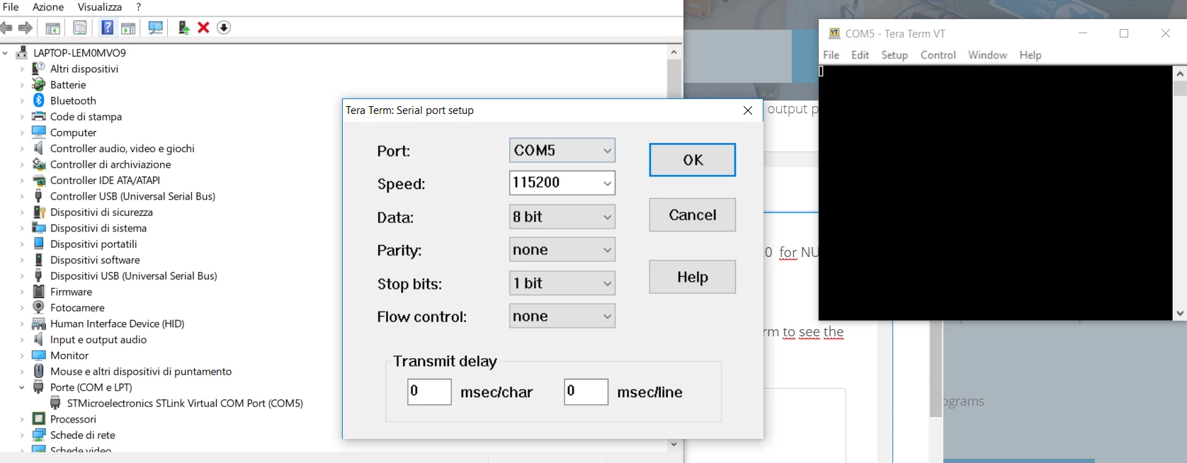

I'm simply want transmit on UART using code generated by CUBEMX 5.1.0 for NUCLEO F401RE in System Workbench (Version: Neon.3 Release (4.6.3)).
I've only added the following code in the main:
UartStatus is ALWAY HAL_OK after every transmission. I'm using Tera Term to see the serial data on COM5.
Thanks for help!

For testing, better use some printable characters rather than codes in control range.
Fore example
char buffer[] = "test";
HAL_UART_Transmit(&huart2, (void*)buffer, strlen(buffer), 1000);

May 4, 2019 7:00 PM UTC
Thanks a lot Pavel! Now works good.
