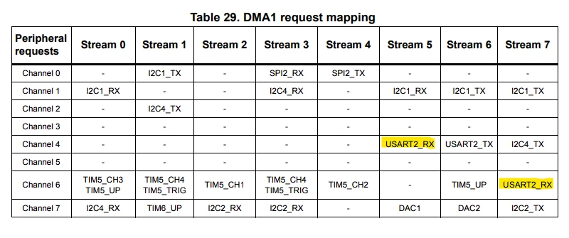

I tried all the possible configuration as in reference manual -

/* DMA1_Stream7_IRQn interrupt configuration */
HAL_NVIC_SetPriority(DMA1_Stream7_IRQn, 0, 0); //Tried Stream5 as in RM
HAL_NVIC_EnableIRQ(DMA1_Stream7_IRQn);

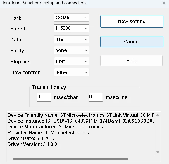

Terminal setting -

 /* DMA interrupt init */
 /* DMA1_Stream5_IRQn interrupt configuration */
 HAL_NVIC_SetPriority(DMA1_Stream5_IRQn, 0, 0);
 HAL_NVIC_EnableIRQ(DMA1_Stream5_IRQn);
