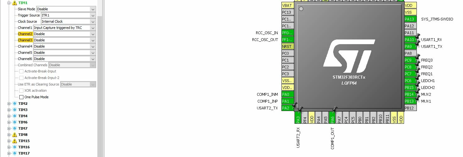

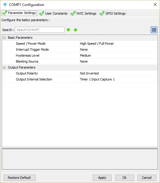

I am trying to Trigger an Input Capture on TIM1 Channel 1 by connecting to the output of the Comparator internally.
I am using a STM32F303and the latest CubeMX+Libs, and I can verify that the comparator is working, as I can scope the output on a selected pin, but cannot get the TIM1 Configuration to fire the Input Capture Callback.

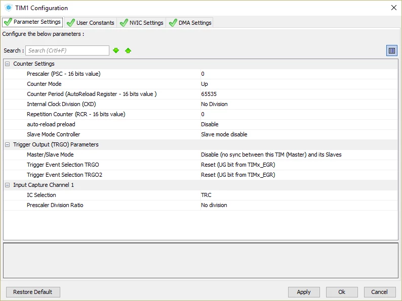

The generated Config Code for the Comparator and the Timer are as follows, I suspect that my set-up for the Timer ins incorrect.
What should the Timer Mode, Trigger Source and Channel 1 Setting be?
/* COMP1 init function */
static void MX_COMP1_Init(void)
 hcomp1.Instance = COMP1;
 hcomp1.Init.InvertingInput = COMP_INVERTINGINPUT_IO1;
 hcomp1.Init.NonInvertingInput = COMP_NONINVERTINGINPUT_IO1;
 hcomp1.Init.Output = COMP_OUTPUT_TIM1IC1;
 hcomp1.Init.OutputPol = COMP_OUTPUTPOL_NONINVERTED;
 hcomp1.Init.Hysteresis = COMP_HYSTERESIS_MEDIUM;
 hcomp1.Init.BlankingSrce = COMP_BLANKINGSRCE_NONE;
 hcomp1.Init.Mode = COMP_MODE_HIGHSPEED;
 hcomp1.Init.WindowMode = COMP_WINDOWMODE_DISABLE;
 hcomp1.Init.TriggerMode = COMP_TRIGGERMODE_NONE;
 if (HAL_COMP_Init(&hcomp1) != HAL_OK)
 _Error_Handler(__FILE__, __LINE__);

 sConfigIC.ICPolarity = TIM_INPUTCHANNELPOLARITY_RISING;
 sConfigIC.ICSelection = TIM_ICSELECTION_TRC;
 sConfigIC.ICPrescaler = TIM_ICPSC_DIV1;
 sConfigIC.ICFilter = 0;
 if (HAL_TIM_IC_ConfigChannel(&htim1, &sConfigIC, TIM_CHANNEL_1) != HAL_OK)

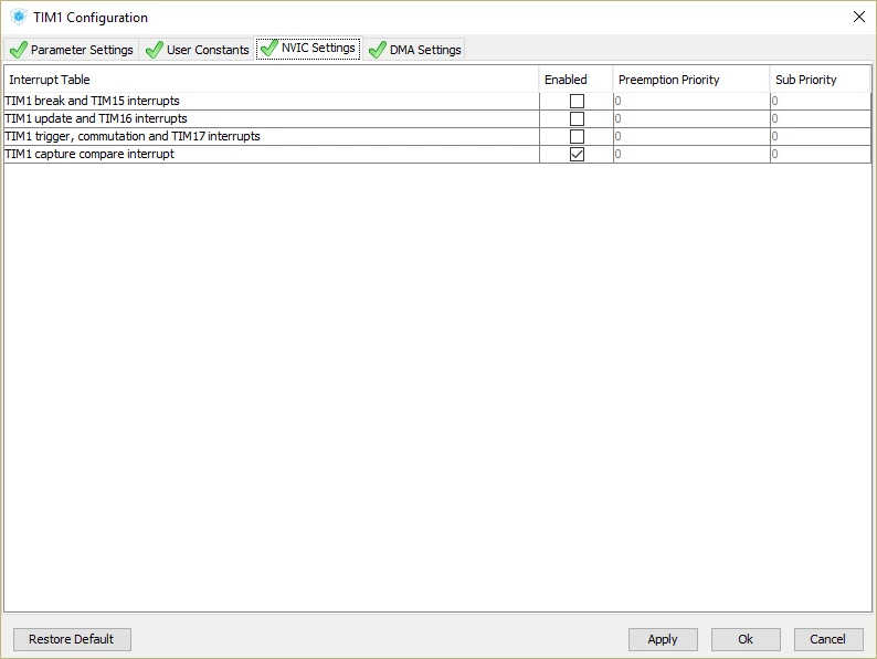

I have attached some screenshots of the configuration and the CubeMX Config File.

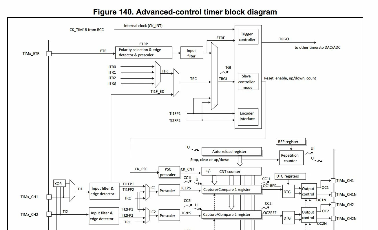

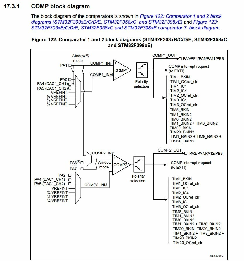

Is there such internal interconnection (comparator-to-capture channel) at all? All I can find in RM is comparator-to-BREAK...
abotha
abothaAuthor
Sep 27, 2017 1:31 PM UTC
Posted on September 27, 2017 at 13:31
Hi Jan
I believe so, attached the COMP and TIMER block diagrams from the Reference Manual;
waclawek.jan
Sep 27, 2017 1:49 PM UTC
Posted on September 27, 2017 at 13:49
Indeed.

the problem seems to be in this line:
sConfigIC.ICSelection = TIM_ICSELECTION_TRC;�?�?
This configuration connects the input capture to the timer trigger.
The correct configuration should be:
sConfigIC.ICSelection = TIM_ICSELECTION_DIRECTTI;�?�?
