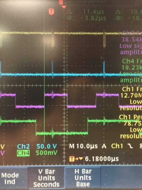

Hi guys,
I am working with the STM32L486 using the CubeMX tool and running into some SPI issue that I can't seem to figure out (I am new to ST chipsets btw). Specifically the
HAL_SPI_Transmit routine takes to long compared to the fraction of the time the data is transmitted, as can be seen in the scope image below with yellow being the clock, blue being the data and pink the test point PA0_SET I wiggle (code below). The scope shows that theHAL_SPI_Transmit takes up to 4uS, which is ridiculous. Any idea how to speed this up close to the time it takes for the data to transmit (around 1.44uS)?
Thanks,
ED
PA0_SET;
Spi.Status = HAL_SPI_Transmit(&hspi2,(uint8_t *) &DDS_Cmd, sizeof(DDS_Cmd)>>1, 2);
PA0_CLEAR;

Consider use of the Low Level HAL functions, especially if you are writing a small number of bytes.

I tried to use LL with CubeMX to generate SPI instead of HAL and it wouldn't run (I don't see the clock coming). I think I am missing something simple but cannot put my finger on. The SPI init runs as follows:

I send a simpel 0x5A5A (16 bit SPI) but see no clocks running. Please let me know what else is needed to get it going.

I used the higher level initialization function HAL_SPI_Init(); followed by LL_SPI_Enable(SPI2);
The latter may be what you are missing.  Also, you may need to enable the clock for GPIOB.
