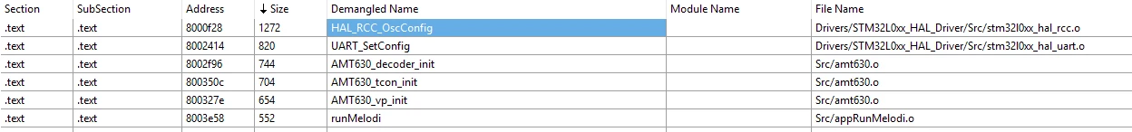

HAL_RCC_OscConfig function takes too much space
Posted on November 15, 2017 at 11:09
Hello
After I face some fitting to flash problem I saw my largest function is HAL_RCC_OscConfig.
I thouht a function that writes static variables to registers should be smaller. Am I doing something wrong or is there a setting for it?
I am using GCC 6_2017q2 with System workbench
#program-size #hal #flash #cube-hal

Cube is aimed at being versatile, which is quite the opposite of optimal. That routine includes setting every oscillator type, even if you don't need it.
Write your own if you want it slimmer.

I enabled 'place the function in their own section '
and 'place the data in their own section ' and it make some difference in code size.
If I face flash overlow again I think I am gonna write my own clock setup code.
I want to try using Low Layer library also.

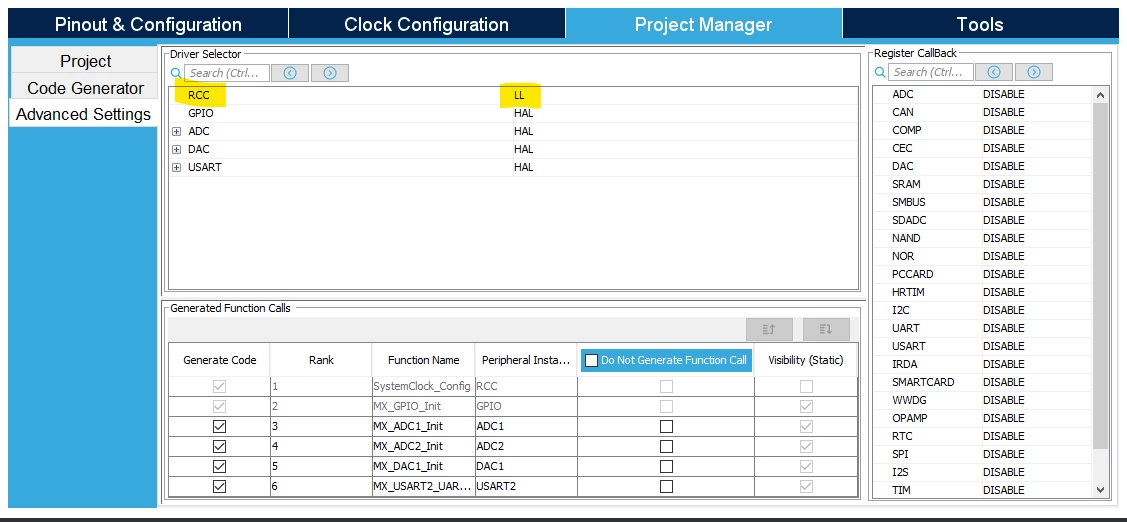

I recently faced the same issue of HAL_RCC_OscConfig() taking too much space in flash. I solved the issue with a very simple trick.
Just change HAL to LL for RCC driver selection in CubeMX code generator in Advanced setting.
Magically, It reduced Code size by almost 40%.
Hope this helps!
