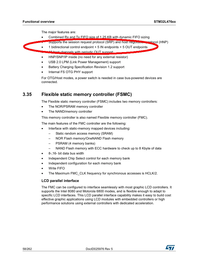

HAL_PCDEx_SetTxFiFo and fifo number/order
Hi, I'm having a hard time understanding the HAL_PCDEx_SetTxFiFo() function that I should call inside the USBD_LL_Init() function for my Stm32L476. I have attach my descriptor results from USBTreeView. But here the highlight:
My composite device have multiple interface:
  • 1 HID interface
    • 1 interrupt IN EP 0x83
  • 1 interface for application
    • 1 Bulk IN EP 0x84
    • 1 Bulk OUT EP 0x04
    • 1 interrupt IN EP 0x85
    • 1 ISO IN EP 0x86
  • IAD Link both CDC interfaces
    • 1 CDC Control interface
      • 1 Interrupt IN EP 0x82
    • 1 CDC Data interface
      • 1 Bulk IN EP 0x81
      • 1 Bulk OUT EP 0x01
I did keep the IAD and CDC as the last into the descriptor since it seem to confuse some COM driver. But I still have a hard time with my endpoints and the call to init the TX buffer, I'm not sure I do the right thing.
Does HAL_PCDEx_SetTxFiFo() use for the fifo 2nd argument :
  1. the endpoint id without the direction (& ~0x80)?
  2. the order they appear into descriptor and interface number?
What is it represent exactly? Can I skip some? How much can be used, is 6 too much?
It seem like if I remove my application endpoints my CDC work normally and when I add them my write cannot be perform since the
CDC_Transmit_FS()
if (hcdc->TxState != 0){
  return USBD_BUSY;
The TXState is always busy. This even if no driver and I do nothing with the other endpoints, the CDC stop working. I suspeect I don't do the rith thing with my tx buffer init with HAL_PCDEx_SetTxFiFo
HAL_PCDEx_SetTxFiFo(&hpcd_USB_OTG_FS, 0, 0x40); /* Default control EP */
   HAL_PCDEx_SetTxFiFo(&hpcd_USB_OTG_FS, 1, 0x40); /* CDC bulk EP */
   HAL_PCDEx_SetTxFiFo(&hpcd_USB_OTG_FS, 2, 0x10); /* CDC interrupt EP */
   HAL_PCDEx_SetTxFiFo(&hpcd_USB_OTG_FS, 3, 0x10); /* HID interrupt EP */
   HAL_PCDEx_SetTxFiFo(&hpcd_USB_OTG_FS, 4, 0x40); /* App bulk EP */
   HAL_PCDEx_SetTxFiFo(&hpcd_USB_OTG_FS, 5, 0x40); /* App interrupt EP */
   HAL_PCDEx_SetTxFiFo(&hpcd_USB_OTG_FS, 6, 0x40); /* App isochronous EP */
Maybe I got this wrong, I'm just not sure how this get link to the proper endpoint or if I overflow the RX space (I have read the F4 only support 0..5, not sure if this is true for the L4?).

waclawek.jan
Feb 27, 2019 12:10 AM UTC
I don't use Cube so won't comment on usage of given function; you can look it up yourself, it's open source.
You didn't tell us which 'L4 are you talking about, so I assume it's 'L476 with respective RM0351; if it's not, look the respective details up in the RM for your particular model.
Also, the code snippet you gave us does not match the descriptor you attached, but that's not that important for the key points.
First of all, the 'L476 contains besides endpoints for EP0 only 5 IN and 5 Out endpoints, so that's probably your primary problem.
(Just a sidenote, in the mainstream 'F4xx there are two OTG modules and the OTG_HS has more endpoints).
The OTG module contains a certain amount of FIFO RAM (1.25kB for the 'L476), and you ought to tell the module how do you want to partition it, between one common Rx FIFO (common for all IN endpoints), and one FIFO for each Tx (OUT) endpoint. This is done by setting OTG_GRXFSIZ, OTG_DIEPTXF0 and OTG_DIEPTXFx registers, see description of these registers in OTG_FS registers subchapter of the OTG_FS chapter in RM. Note, all FIFO-related values are in words (how does this translate to the requirements of Cube/HAL functions, is up to you to find out). The Tx-FIFO registers generally contain not only the size of FIFO, but also its beginning, so the user can partition the FIFO in non-continuous chunks (even if this does not make much sense).

Jerome Godbout
Feb 27, 2019 3:27 PM UTC
@Community member​
yes we are using Stm32L476 as stated in the first message.
Thanks for the information. If the number of endpoints is limited to 5 IN and 5 OUT + the Control IN/OUT EP 0 if I understand well, that could explain the problems I see. I was not there when they did choose the hardware and I trying to add features into existing code.
I might need to revise my whole design. But I did not knew this limitation I knew it was 1.25 Kb RAM buffer was available, since we are using small packet for 2 interrupts (0x10 for 16 multiples each) we could still have some RAM availables for a few endpoints with each (0x40).
I did check that document:
https://www.st.com/content/ccc/resource/technical/document/application_note/group0/0b/10/63/76/87/7a/47/4b/DM00296349/files/DM00296349.pdf/jcr:content/translations/en.DM00296349.pdf
Where is this limitation documetend? is it HAL limitation or the chip itself? I will add an assert so anybody who will try to do this on the chips will not compile anymore. We though based on this presentation from ST that we were having 8 bi-directional endpoints (16 totals) on page 3:
https://www.st.com/content/ccc/resource/training/technical/product_training/98/89/c8/6c/3e/e9/49/79/STM32L4_Peripheral_USB.pdf/files/STM32L4_Peripheral_USB.pdf/jcr:content/translations/en.STM32L4_Peripheral_USB.pdf
This is a bummer, since the CDC use 2 of them already, 1 for HID, that leave me with only 2 on the application control. I will go 1 bulk and 1 interrupt and remove the isochronous one. This is a rather complicated device that is used by 3 different drivers (1x HID driver, 1x VCOM for debug and production and 1x custom driver to control and operate the device).
Anyway thanks for the information, I will trim the design and see what I can do.

waclawek.jan
waclawek.janBest answer
Feb 27, 2019 3:59 PM UTC
Sorry, I overlooked that information.
Yes, but bear in mind that the sum of Rx FIFO and all Tx FIFOs is max. 1.25kB, i.e. max. 0x140 words).
> Where is this limitation [max. number of endpoints] documetend?
and also at several places in the OTG_FS chapter in RM.
That presentation talks about the lower-end 'L4 range, see page 2. They contain an entirely different device-only USB module.
